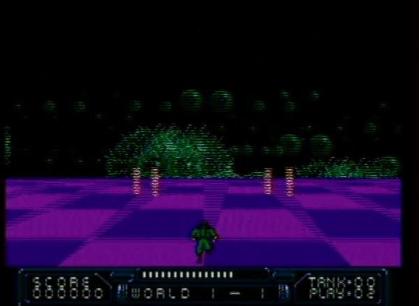

    Hi everyone! I managed to get my Famicom 3D System working on a PC CRT using a NES Emulator on my PC. Inside the spoiler is the process I took to do this.
    So I wanted to play Tobidase Daisakusen in 3D on my Famicom Disk System. I strapped on my Famicom 3D System glasses, fired the game up, and was disappointed to find out that the 3D feature only works with red/blue 3D glasses. Unfortunately, I don't have a pair of these. So, I enlisted the help of two friends and we started digging.
    The US version was released on cartridge as The 3D Battles of World Runner. The game has a 3D mode in the ROM but it is disabled. Using a Game Genie, you can enable it. However, this isn't red/blue 3D. It is actually stereoscopic 3D, the same 3D used by the Famicom 3D System! This is great and all but there was one issue.... I don't have the actual cart, Everdrive N8, or a Game Genie! This lead me to emulation.
    I decided to try the game in Nestopia Undead Edition. I grabbed my old VGA CRT, plugged it into my modern PC using a DisplayPort to VGA active adapter and set the CRT to 640x480p@60Hz. After firing up Nestopia, I entered the cheat and loaded the US version. I held B and then pressed START. Afterwards, the game is at a black screen. Letting go allowed the game to display again and pressing SELECT toggles 3D!
    Next, turning on the glasses. I plugged them into my Famicom and loaded up Falsion on the FDS, which turns the 3D System on at the title screen. Sure enough, it worked on 3D World Runner and the VGA CRT! The 3D effects were good and it looked amazing. I did notice an issue with a vertical gar bar going up the screen but I have been told that is due to the refresh rate. I'll have to find out what the exact refresh rate of the Famicom is and run my PC in that mode to see if it fixes it.
    TD;LR: Famicom 3D System works on a PC CRT running at 640x480p@60Hz and in Nestopia Undead Edition. You need the following:
    • Famicom or NES with a way of connecting Famicom accessories.
    • Famicom/FDS game that can enable the glasses.
    • PC CRT set to 60Hz. I chose 640x480p because it is a perfect 2x scale.
    • Famicom 3D System.
    • Emulator of choice.
    • ROM/FDS image of a stereoscopic 3D game for the NES/FC/FDS.
    A 3DTV might also work but I have no idea and no way to test that. I've read somewhere online that you can also get or build adapters to use the 3D System glasses on a PC without the need for a Famicom.
    Hope this helps anyone looking to play Famicom 3D System games on emulators!

    i coud test it on a 3DTV, since ive got one.
  3. abveost
    abveost Robust Member
    Dec 15, 2014
    273
    Odds of to separate 30hz signals being perfectly in sync is slim. That could be the cause of the distortion. But I'm surprised it works in any usable way.

    Hmm, I wonder if there is any way to make it perfect. Funny thing about it, I stopped using it for a bit and then decided to reload it after a while. I couldn't get it to work anymore. Maybe I changed a setting or something somewhere down the line. I'll have to do more testing.
  5. abveost
    Dec 15, 2014
    273
    Most likely you just hit one one of those one in a million (probably a lot less) instances where the two signals were in sync. To make it perfect you have to have the console and the glasses in perfect sync. The way this is usually done is to toggle the glasses with a signal from the same system generating the display. This means connecting your emulator to the glasses. This used to be a lot easier than it is today. But source for your emu of choice is available so theoretically possible.

    I'd check the odds before investing in the lottery. A million to one ain't nutten. I'm pretty sure nvidia made USB glasses but no idea how they worked but they're not going to work with your emulator unless someone wrote the code to do that.
