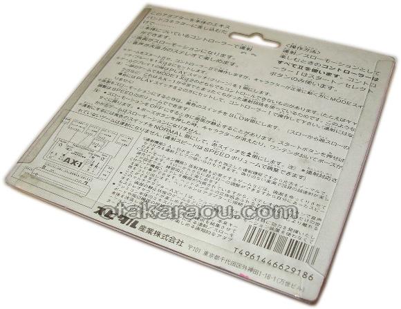

    The play switch should change the autofire between players one and two. Try plugging in two pads in the system as it was designed for the original FC which had two pads hardwired in.
    Not sure what the Mode switch does, but here is a (poor) scan of the back.

    I still wonder what the MODE and PLAY switches do.
    @ Jamtex: thanks for the scan. Hopefully someone can translate a few lines.
