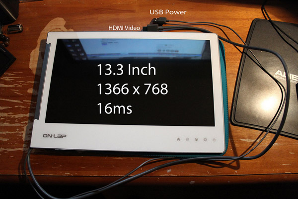

    Yeah that was my thoughts just get a smaller one. Not a big issue anyway, my disk system needs a new belt, which I have but haven't gotten around to replacing so its in storage. Mostly just a curiosity question about if I could possibly find a parallel to USB working in DOS for anything. Most likely in the end I will just find a cheap mini ITX board that either has the ports or a PCI slot I can add some and use my USB powered HDMI monitor (pic below cause I felt like sharing :p ) to pretend its a laptop. Thanks for the info guys!
