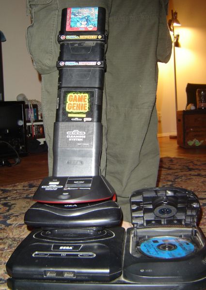

    So the RAM cart would just... hang down in front? Might not be a good idea for anything bigger than a normal fc cart. I'd definitely add a ribbon cable or sth so everything can be placed down properly and there's less mechanical stress on everything.
    Guess Nintendo fans now get to build their own version of this:
