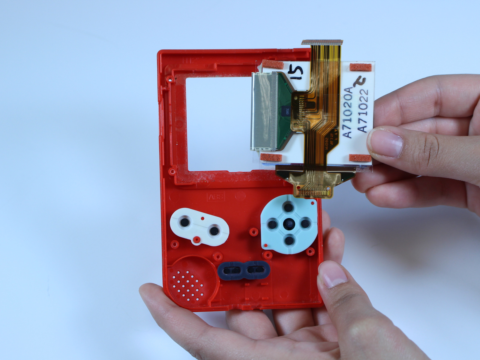

    To illustrate AndehX's point - you'll be peeling the polarizing layer off the lcd screen... (see photo)
    When I attempted this - I was able to peel it properly from the top and left sides, then I tore the very flimsy ribbon cable on the bottom of the screen. The cable itself, like the DMG, is not easily repaired or replaced.
    I'll likely try it again (as I am a glutton for punishment), but I haven't got the heart to trash another Gameboy Pocket anytime soon.
