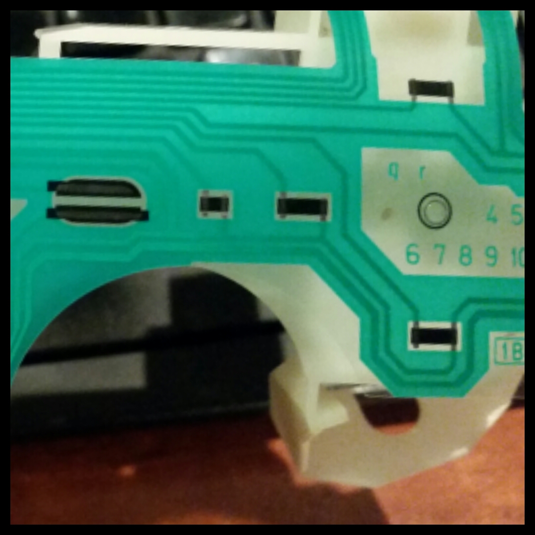

  12. dekkit
    dekkit Member
    Oct 12, 2017
    Having recently examined a few broken PS2 controllers to find out exactly why they stopped working, this is one of the best explinations Ive found that addresses the underlying issue.
    Commenting to raise the profile of this post.
    A lot of forums discuss pulling apart controllers to clean them etc etc, or incorrectly identifies the issue as being the cable from ps2 to controller (which can get brittle), but examining the ribbon pcb closely you can clearly see the lines fading in areas exposed at the upper side in support of the above.
    In my pic below, you can see the difference between the middle and right sides in how faded the pcb has become overtime.
    While fixable with pcb trace pen (ie redraw the lines), these ribbons are replaceable for a few dollars via quite a few online stores but check models as they do vary.
    The pcb on mine need to be soldered to the main controller board.
    Almost all of my original controllers have stopped working to some degree (some or all buttons dont work). While the replacement wireless controllers are cheap, the originals were great and worth restoring.
