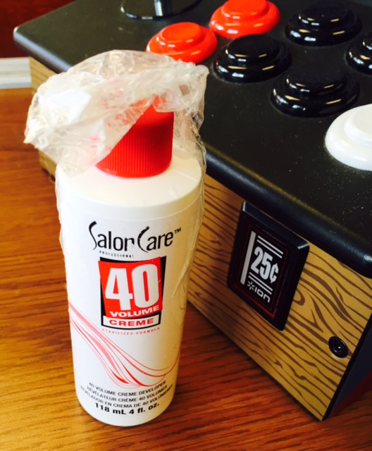

    I'm sure this has been covered before but I did a search and couldn't find anything, so thought i'd share just in case someone new like me hadn't heard of this yet. Using salon care 40 creme on yellowed game consoles works amazingly well!

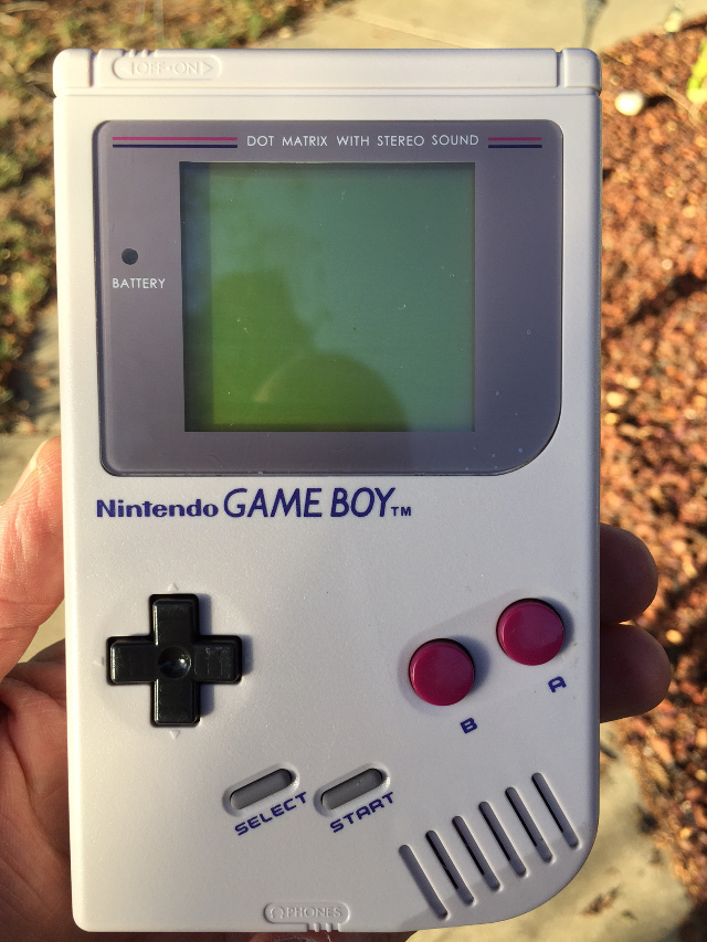

    Asked my children to look for any old game stuff for me and my daughter found an old original Gameboy in a box of crap and it was ROUGH. Filthy, filled with gunk, missing the screen protector, not working etc....and yellowed, especially the front. After I took it all apart and cleaned everything up I brushed some of the aforementioned salon creme a friend of mine let me borrow on the case, then I placed the case in a pyrex dish with tin foil in the bottom, put some cellophane over the top and placed it outside in the sun for about 6 hours. Came back and that sucker looked brand new! Man I wish I'd taken a before picture.
    another bonus was it didn't work before but somehow after I took it all apart and cleaned everything, it works just fine now. A nice free edition to my collection.

    Wow, that does look pretty nice, and it didn't ruin the letters on it either.

    Nice result. Not surprising though. It's 12% hydrogen peroxide, the same as recommended for the retrobright mix.
