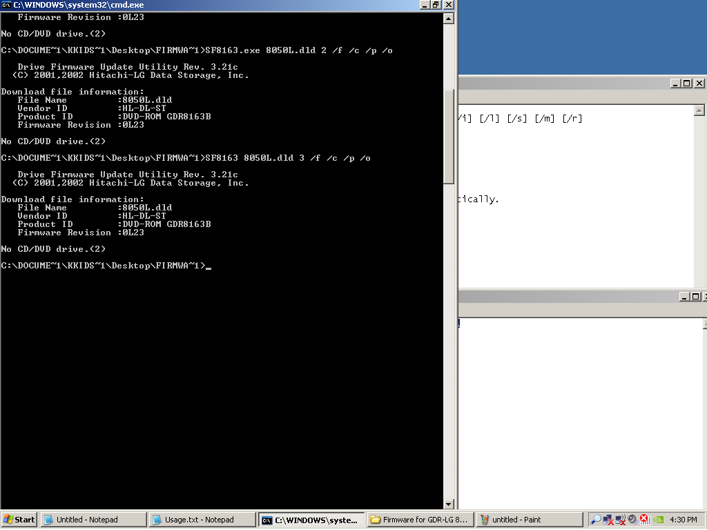

    Redit: So I was able to run the program using command prompt, but for some reason the program does not see the drives. I have tried flash a could of times now but all I get is this
    I tried adding the /r switch too but no luck. I know these drives work fine, because I have already tested them. I have one of the drives on secondary master and the other on secondary slave. They are recognized and play media without a problem, so why can't this program see the drives?

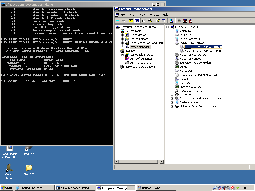

    Rereedit: Okay now I see a problem. I tried running the problem without specifying the drive #, so that the optical drive would be detected automatically, but this is what it comes up with
    I brought up device manager on the left of the screen to show how the drive detected has a vendor id of HL-DT-ST whereas the vendor id the program is looking for is HL-DL-ST. So does this mean that I have the wrong drive? I can't seem to find the vendor ID HL-DL-ST anywhere on the internet though, maybe this was a mistake in the 8050L.dld file? Could I just edit the 8050L.dld file so that instead of having id number HL-DL-ST in it, it would have HL-DT-ST in it?

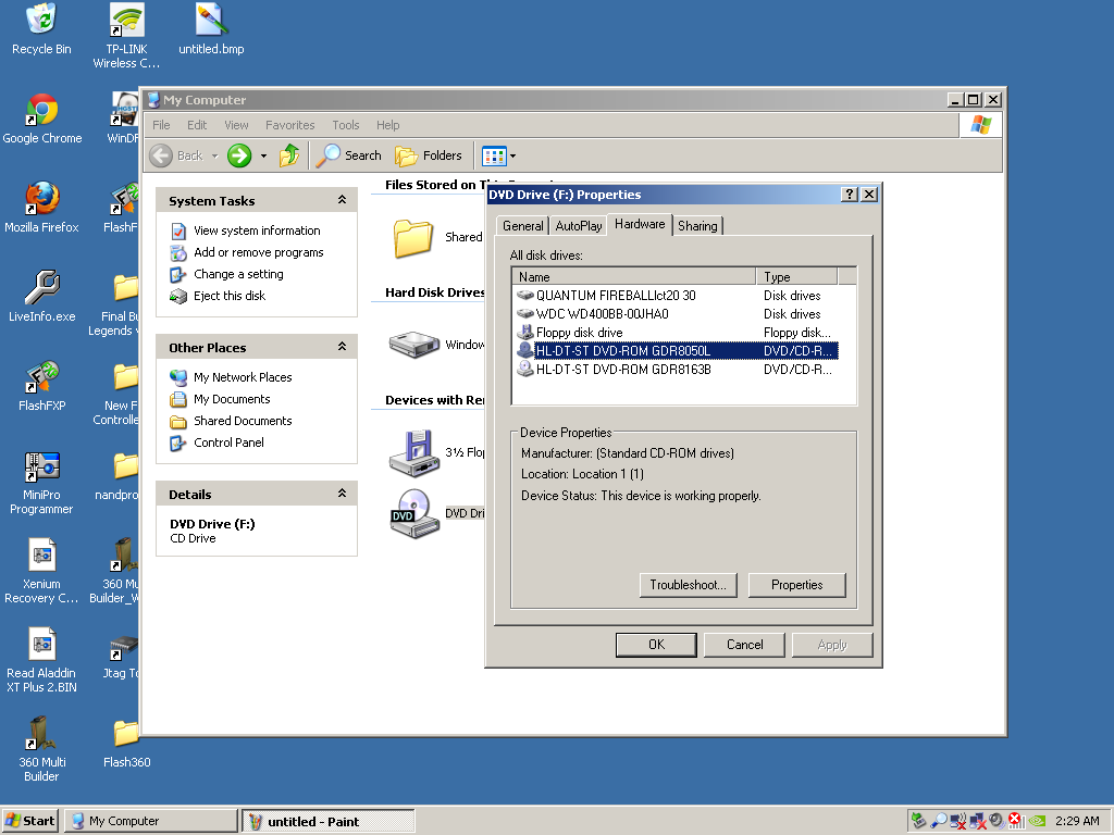

    Edit: I ended up trying to flash the drive a few more times and each time it seemed to complete successfully, I even flashed it once with the /l (log switch) and according to the log it completed successfully as well. I was also trying to see if Windows XP would recognize the disk and eventually I found a combination that allowed the drive to be recognized. I had the drive set to cable select, and another GDR-8163b set to master on the secondary IDE channel. Windows not only recognizes the drive but I can still load media with the drive. Here is a picture to show that windows does indeed recognize the drive, and that it does have the 8050L firmware flashed to it.
    I am not sure if this is how the drive was before when I had the drive in the Xbox or not, but I am assuming that either I had it all right before and just did not get the drive and jumper combination right with the Xbox HDD or possibly the through hole resistors were the problem. Is there any reason why surface mount resistors would only work for this project and not through hole resistors? I did rip some pads off the backside of the drive's PCB trying to solder and then desolder the resistors to the pads, but I have found where the traces connected to those pads lead to. They lead to some VIA's that I can solder some 30 AWG hookup wire to, so I guess I am ready to try it all over again. I am debating whether to try 680ohm resistors this time because in the GDR-8163b tutorial the author mentions that he got reliable results with both 1kohm and 680ohm resistors. What do you guys think, should I try this time with 680ohm resistors?

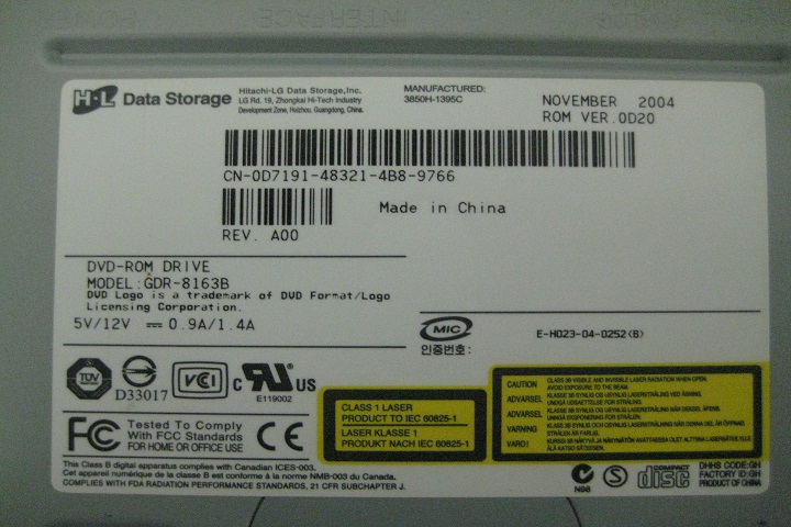

    Redit: Okay I tried again, and again it failed, but I think I might know what the problem is now. The drive is a LG GDR-8163b but it has a different rom version to it. Instead of being rom version OL23 it is rom version OD20. Here is a picture of one of these drives that I have
    I don't know the difference between the LG GDR-8163b from the tutorial and the one's I have, but it seems that the difference is considerable enough to not allow the drives I have to function properly in an Xbox after being flashed with the 8050L firmware. So I guess there is no hope in getting these drives to work in an Xbox then, unless someone knows of a way, and would be willing to share the info with me. I think I am going to have to try and flash this drive back to its original firmware now, and I can't seem to find it anywhere :( Anybody know where to get the firmware for a GDR-8163b OD20?
