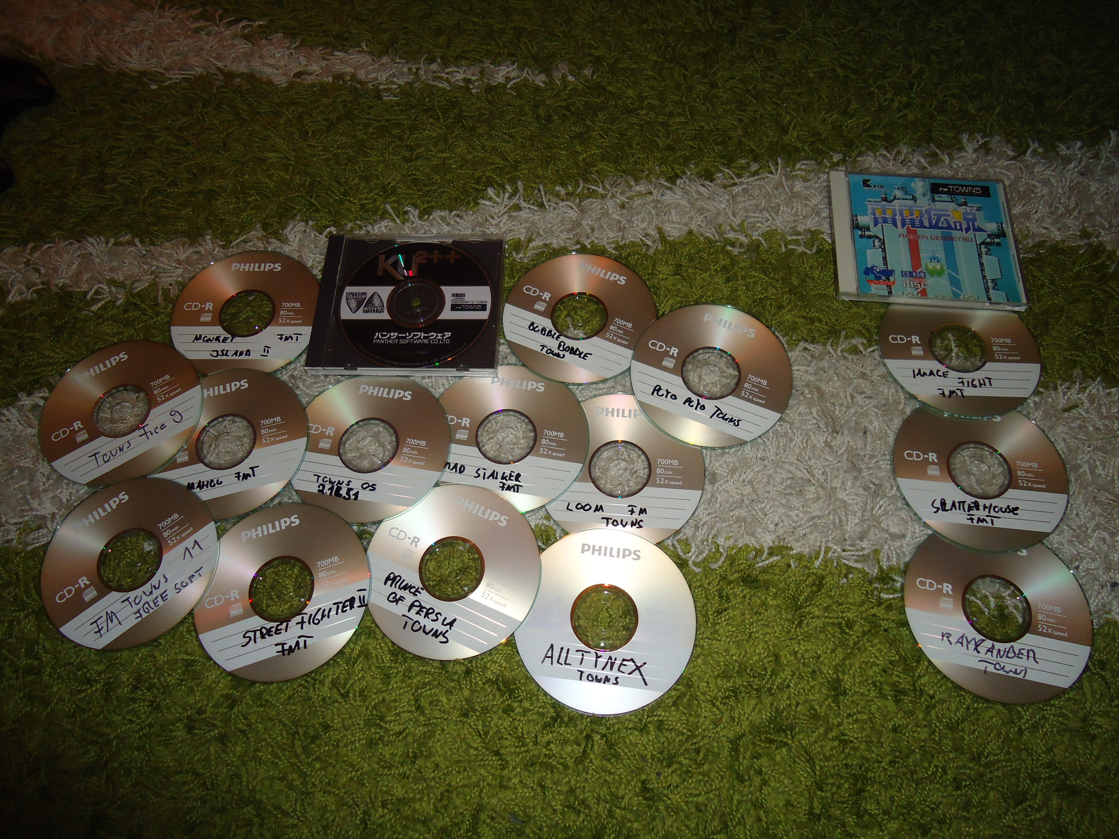

    Hi guys, i am messing around with FM TOWNS SCSI CD Rom and i may be further than anyone else ever was;
    My System boots SCSI CD Roms and i can lanch Bubble Bobble, Street Fighter, Loom, Ku2++ and Prince of Persia from SCSI CD. I also can play Music CDs in Towns OS.
    I tried different settings with Dos 3.1 and 6.2 but now i am stucked !
    No Ving Game aside from Bubble Bobble will boot, i can list the Splatterhouse files in TOS and even boot lower TOS from the CD but then when i click SH.EXP it hangs. Same for Raiden!
    My current idea is to edit the ISOs and fix this issues but i have no clue where to start?
    The ROM Loader TBIOS.SYS also looks important and for BB i have to preload VINGBIOS.SYS. For SH it makes no difference what kind of Bios is loaded, it still hangs.
    Please let us solve this problem, my internal drive is dead and all others will follow soon :)

    Games running so far;
    Bubble Bobble
    Loom (i think all LA games)
    Street Fighter
    Ku2++
    Prince of Persia
    Alltynex (Rumstorm Rumruder should also work fine)

    War Update 1.000.298;
    Left side works via SCSI right side does not work.
    I also have the Raiden title screen and Rayxanber music but then both games crash. Have to invest those further.

    Very nice chat @ facebook today. With forces united we where able to run a few more games from HDD; Image Fight and Flying Shark (no music). Still have to find a solution for many other Ving games and Rayxanber, Raiden, Splatterhouse & Co
