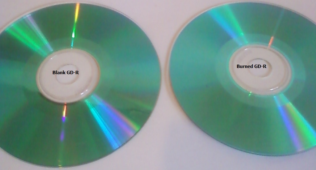

    The high density area on a burned GD-R looks just like the low density area on a blank so you can easily spot which is burned or blank at first glance due to the shiny low to high ring and a dulled high area. A blank's high density area is shinier because there is no data there.
    My blurred pic doesn't help resolve matters (shit camera on my shit 'phone) but that disc looks blank to me, but it doesn't hurt to check them all using the wombat method.

    Gdr
    Cool thanks for that :very_drunk:
