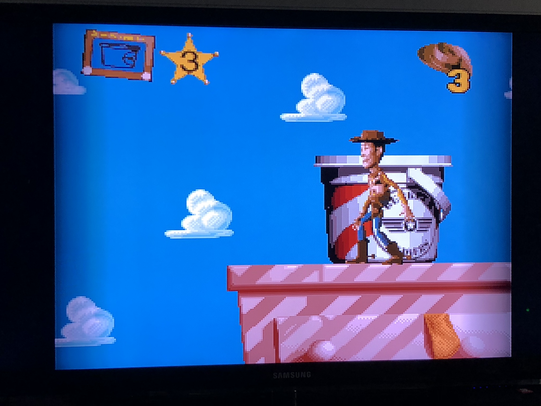

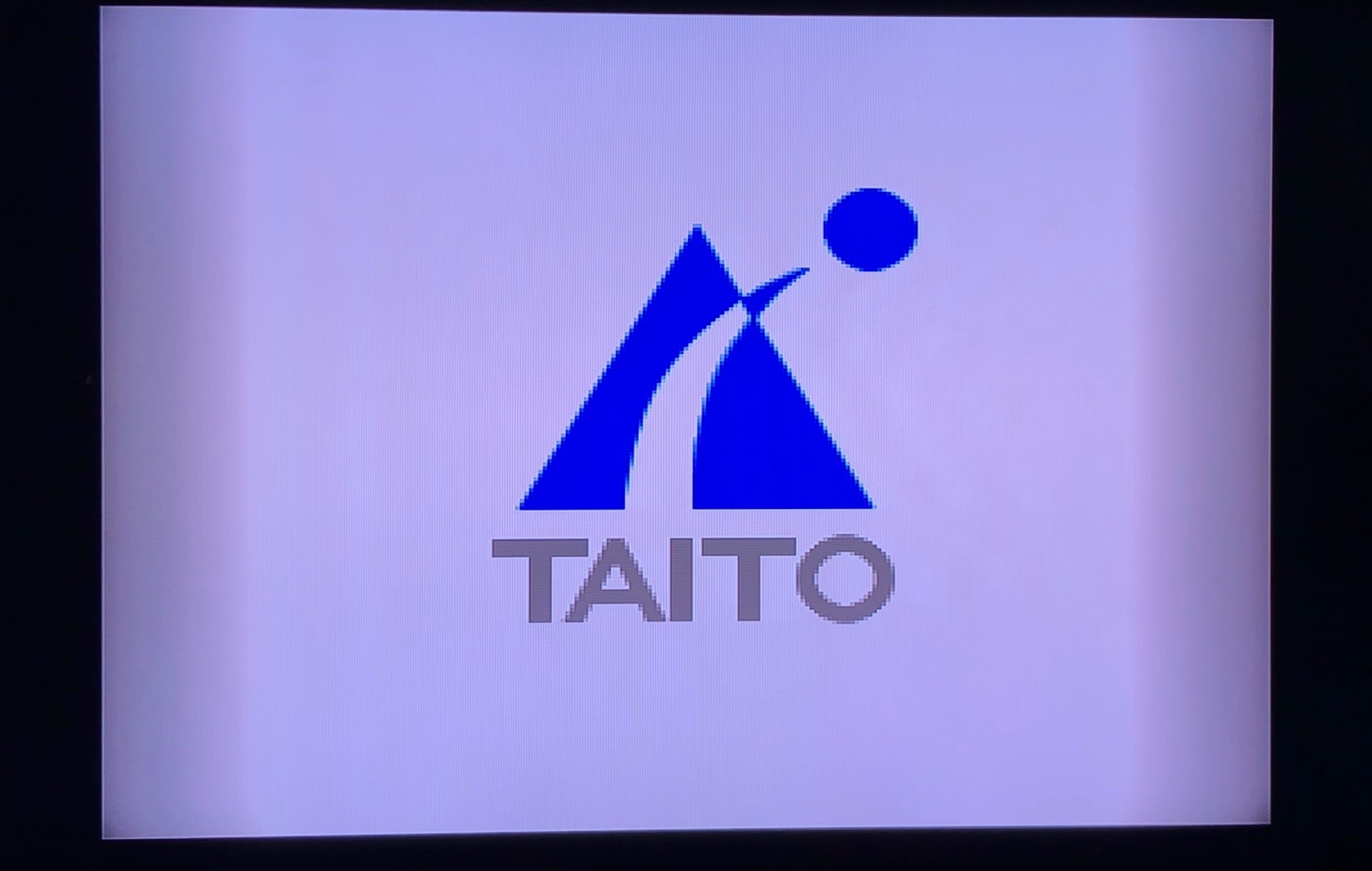

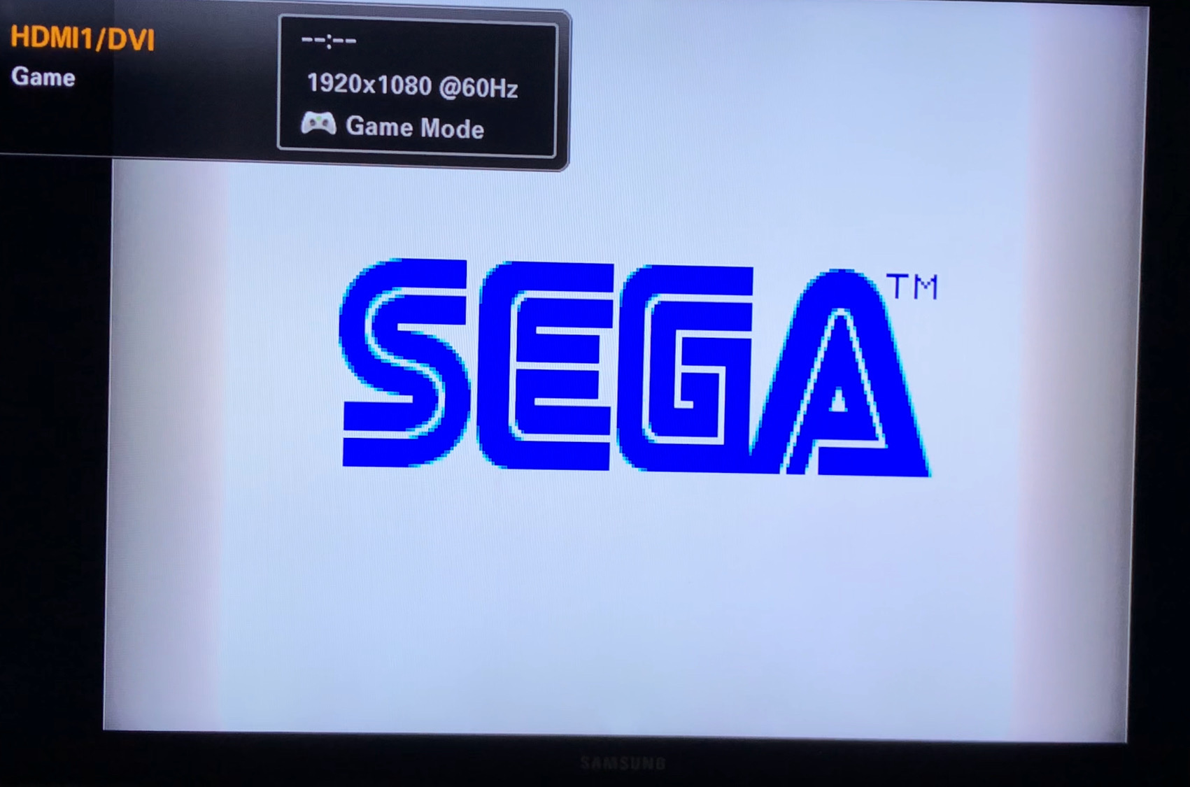

    Just got a Framemeister about a week ago and I have issues with the outsides of the image being dark. I'm using the latest firmware v2.03a with all Retro-Access cables. I have tried 3 TVs and they all do the exact same thing. I've tried FirebrandX profiles also. This happens on any system I use.
    Anyone have any idea what's going on?

    That's one of the Retro modes, found under special menu. It's supposed to simulate the glass curvature of an old tube TV. You must have turned it on somehow, it shouldn't be on by default.
    Keep this Framemeister menu flowchart handy so you can find the option to turn it off.
    http://micomsoft.co.jp/XRGB-mini_Ver203_OSD_E.pdf
