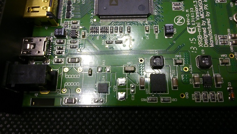

    i have check the motherboard of my framemeister
    and there are no fuse.

    I find it most annoying that there are filtering components missing...

    It will be fine, the PSU will have it's own 120v fuse, the Electricity never even made it to the transformer coils..
    quick and dirty test, splice the cable into a usb cable and power the unit off a 2amp usb charger or off a PC (depends on motherboard, my Gigabyte board has the USB ports rated at 2amps)
