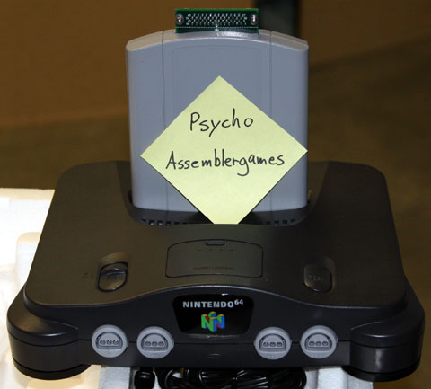

    This is a boxed Nintendo 64 IS-Viewer development cartridge. Info I've found online explains what it does:
    "A high speed debugging tool which allowed you to send a 96mbit image from a PC in under 6 seconds (2MByte/sec)!"
    This is packaged in the original box it was shipped in, which is just a Japanese Nintendo 64 box with IS-VIEWER and it's serial number hand written on the side. These were originally sold with a Nintendo 64 base unit, so they just used the boxes the N64s came in. It only has the base unit and power supply, no controllers (that's where the IS-Viewer cartridge sits).
    You get: the IS-Viewer cart, the N-64 base unit with power supply, and the box. I don't have any software for it, but I believe it's programmed using the Intelligent Systems Nintendo 64 DevKit.

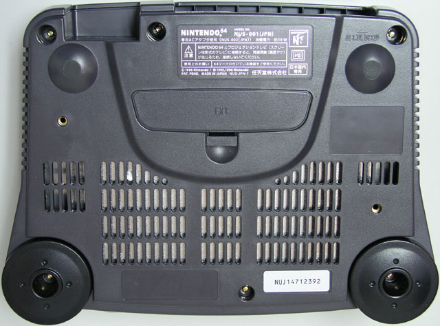

    Take a look at the bottom sticker or inside at the n64 and see if it's a debug.
  3. Psycho
    Psycho We've gone plaid!
    Oct 25, 2005
    379
    As far as I can tell, it's just a normal Japanese N64... Here's a couple of pictures of the bottom of it, would I be looking for the word 'debug', or is it the model number that's important?
  4. ASSEMbler
    Should be one. Debugs generally lack stickers on the bottom, only way for sure is to check the mainboard for themodel make. Nice stuff.

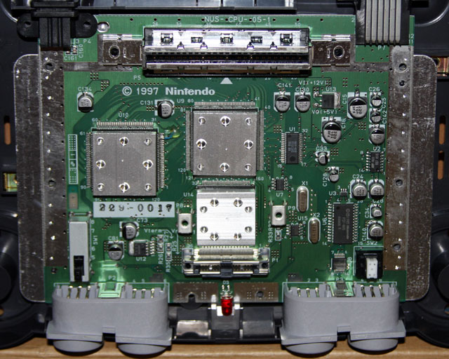

    Here's the main board:

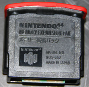

    It also has a memory expansion cartridge included:

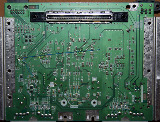

    Looks like a Partner-N modded version of the N64.. See the blue cable on the right side of the R4300i?.
    What the Partner-n requires is to "forward" an interrupt of the R4300i (int 4 If I remember correctly) to the PI (on a Stereo pin, either 48 or 49) to enable breakpoints.
    Would you mind posting a picture of the back of the N64 board as well for completeness?
    I think it probably has just the same modding.

    Heh, when I saw the blue wire, something was telling me someone might ask, so I photographed the back side as well, just in case... ;-)

    It has definitely the same or similar mod of the partner-n! Which doesnt surprise me at all.

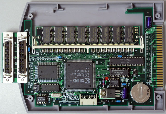

    Actually, I think it's a SCSI connection, isn't it? (It's that kind of connection at least.) One of the ideas with this was speed- it can transfer a 96MB image in seconds... Can Parallel do that even if it wanted to?
    It came in the box pictured at the top, and the box is labelled with the contents (mentioning the IS-Viewer) and a serial number. I'm assuming this is how they were originally boxed, but I'm not 100% sure about that. I figured IS bought N64s, modified them, packed the cartridge in the box where the controller went and shipped them like that.
    No cables or software were included. Standard SCSI card and cables should work. According to Intelligent Systems' website:
    "We prepared a program download execution debug tool"
    I assume this is what they are referring to.
    It only has a 32MB EDO RAM SIMM in it, so it can only handle a 256MB game image. However, it's an off-the-shelf SIMM, so it's possible you can upgrade it to a 64MB one to increase the game storage. There's also a tiny bank of DIP switches on the main board of the cartridge... Not sure what these do.
    Check out the pictures on Shiggsy's site if you want to see what the board and the memory look like (or I can post my own here if people want). This is the exact same cartridge I'm selling here (I bought the one he has pictured on his site a few years ago).
    http://shiggsy.gbadev.org/unit.php?unit=40

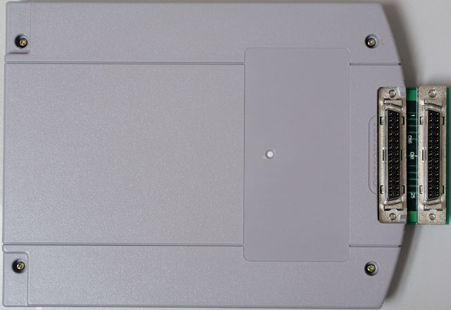

    (Oh hell, I just realized I never showed a pic of the back side of the cart with the connectors, so here's that and a circuit board pic:)

    That's definitely a 50-pin SCSI interface. (SCSI-II) There are two connectors for daisy-chaining additional peripherals.
    There is a small white 6/7pin connector on the board, probably JTAG for configuring the FPGA.
    The dip switches likely select the FPGA configuration source (boundary scan or on-board flash), and might possibly select memory size (not likely) or enable an on-board active SCSI terminator (more likely).
    You are probably right about the box; at this price they were probably made in very small production runs (the back casing itself has been hand-trimmed to accomodate the SCSI ports).
