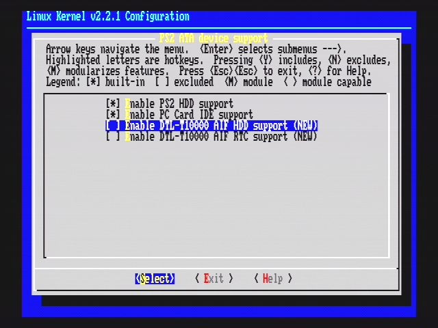

  10. SilverBull
    SilverBull Site Supporter 2010,2011,2013,2014,2015.SitePatron
    Jun 12, 2008
    385
    I can only speculate, but my guess is they hadn't finished the HDD interface by the time these boards were designed. In my opinion, the whole DEV9 interface is a kludge.
    The PS2-side HDD is not accessed during normal operations. It resides at other I/O addresses than the PCMCIA interface, so it needs special drivers on the IOP. Although the homebrewn dev9.irx checks for the TOOL (there seems to be a small difference in how the PCMCIA controller is connected to the IOP), it does not provide access to the on-board IDE controller, just the normal one on the PCMCIA card. On the other hand, the PS2 Linux kernel is reported to contain a matching option.
