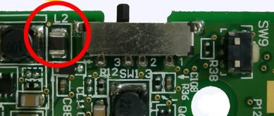

    I was attempting to install a new bottom screen on my DS Lite, however, I did not secure the ribbon cable properly before turning the console on and I appear to have blown out the fuse. Which fuse is sufficient for repair? Or would it be more efficient to purchase an entirely new board?

    These? They're regular L2 fuses, you shouldn't have problem finding them anywhere. Or you can just solder two connectors together, but that's a bit ghetto way and unsafe.
