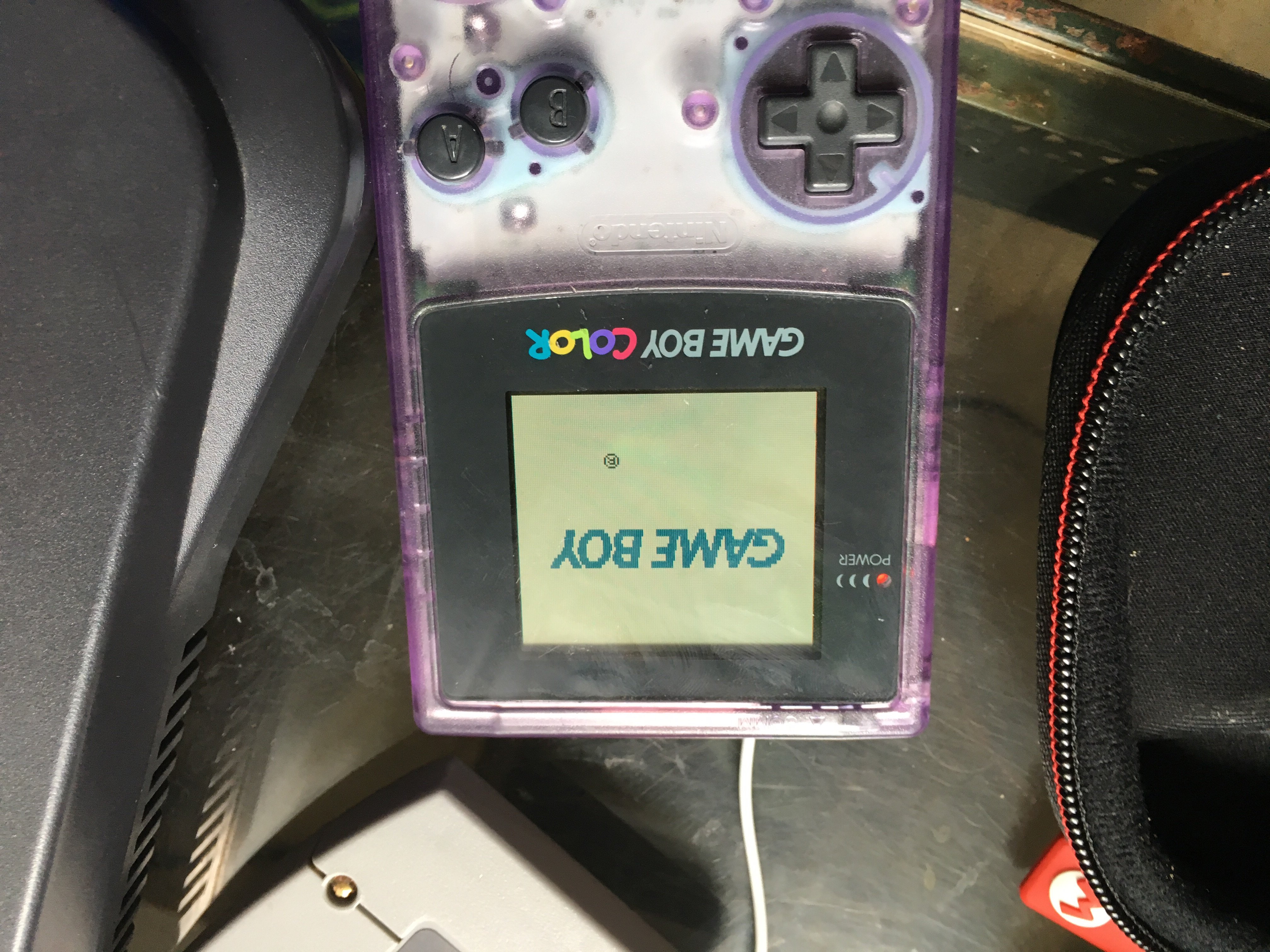

    So I have a copy of the Looney Tunes Twoble that is detected but won't boot. There was a funky looking trace somewhere connected to pin 23 but I can't find it anymore . It would help if I could find a schematic for it but I am not having any luck any ideas?

    Try to resolder the mapper and the rom

    I can try but my soldering skills is a joke. Hey the game was like 3 bucks. Any tips?

    You just have to heat the pins. I had the same problem with mario dx (ROM) and donkey kong (mapper + rom).

    Game now boots:D thx everyone
