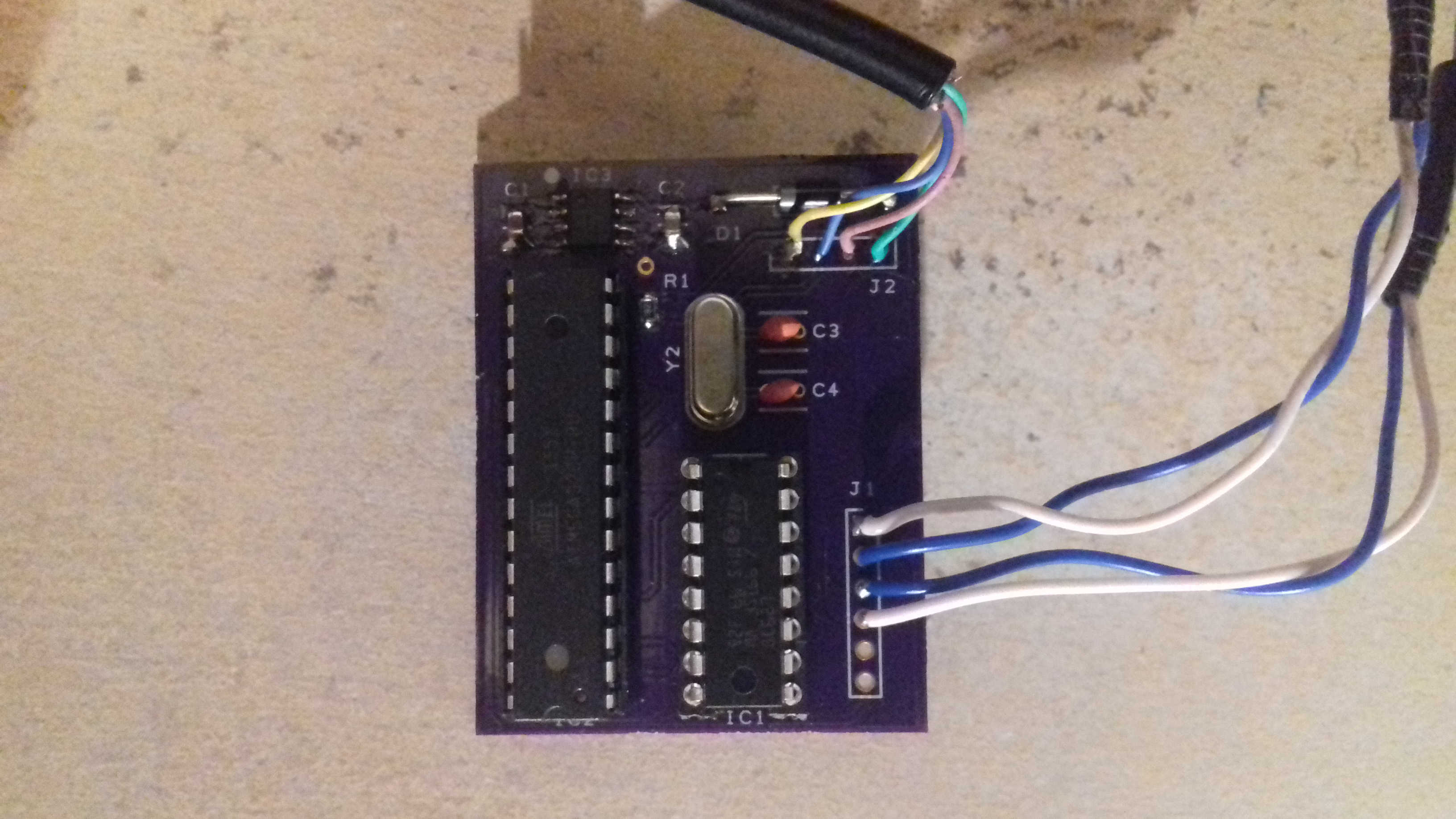

  7. happy_bunny
    happy_bunny Rising Member
    Feb 17, 2016
    71
    Created a PCB now the atmega gets its power from the GC serial port 5 volt line and I added a voltage doubler so I dont need the external 10-12V power supply.
    Its not perfect no mounting holes and the J2 connect holes are a bit small but it works, schematic / PCB artwork and BOM is on my website.
