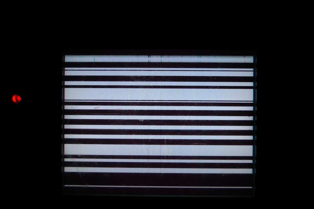

    Hello,
    I bought a GameGear in poor condition on a flea market, at least the price was good just for the game included.
    I recapped the main and sound PCBs; I can hear the music but the screen stays like that, whether there is a game or not:
    I found this video, where you heat the black chip on the right (yeah, don't laugh too hard).
    Since I had nothing to lose, I tried, but nothing changed.
    Is there something I could try, or is it definitely dead?
    Thanks.
  2. APE
    Pretty sure there is more ribbon there than that one tiny section.

  4. Dreamkey
    Dreamkey Active Member
    Dec 10, 2012
    36
    I checked each pad of the ribbon, and all of them are correctly soldered. It seems that I can't do much more, except this TV output mod.
  5. Tofan
    Tofan Member
    Feb 27, 2015
    I would go back and re-check all of your capacitors and make sure they are oriented correctly. The only time I haven't been able to fix a Gamegear screen is when they were physically cracked, broken. You can even fix it if the ribbon has pulled from the motherboard. Also what kind of capacitors did you use?
