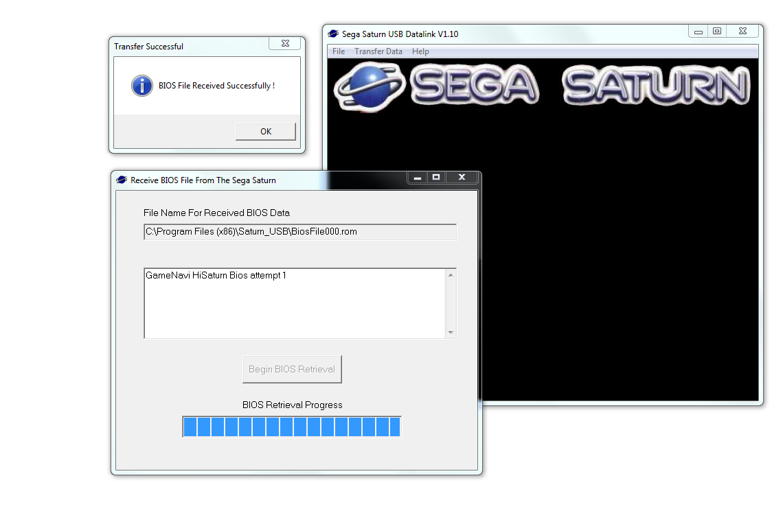

    Got this this morning from my Navi. Used the saturn USB datalink. i have no idea if this is the same as the normal hisaturn bios. Loaded it into SSF and it seemed to work okay once i renamed it to a .bin. Would love for someone else to independently confirm a proper dump, and to check if there is anything special about this bios versus the normal HiSaturn bios. Also, please check if this can be made universal.
    Thanks all
    Filename: GameNavi_HiSaturn_Bios_v1.03_Dumped_2014-01-25_A_Murder_of_Crows.bin
    MD5: 0306c0e408d6682dd2d86324bd4ac661
    SHA1: 8c031bf9908fd0142fdd10a9cdd79389f8a3f2fc
    CRC32: 6abfefea
    Modified Time: 1/25/2014 6:34:52 AM
    Created Time: 1/25/2014 6:33:34 AM
    File Size: 524,288
    http://amurderofcrows.net/Navi/GameNavi_HiSaturn_Bios_v1.03_Dumped_2014-01-25_A_Murder_of_Crows.bin

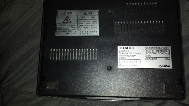

    I've owned the Navi since december, and i'm very much in debate with myself regarding modding it with a universal bios or a region switch. I did know that i probably needed dump the bios if i wanted a universal option
    I have to get some chips ordered from Bad_Ad84 and figure out some way to socket this so i don't need to alter the original bios all that much. I have a programmer now, but no cheap source of the appropriate eeproms.
    I also need to figure out how to install a mod board on this thing, and probably a lid lift.

  6. Bad_Ad84
    1,308
    I think you mean 8mbit.
    You technically only need 4mb, which is what I use at the moment. But I get which ever I can get - install is the same.
