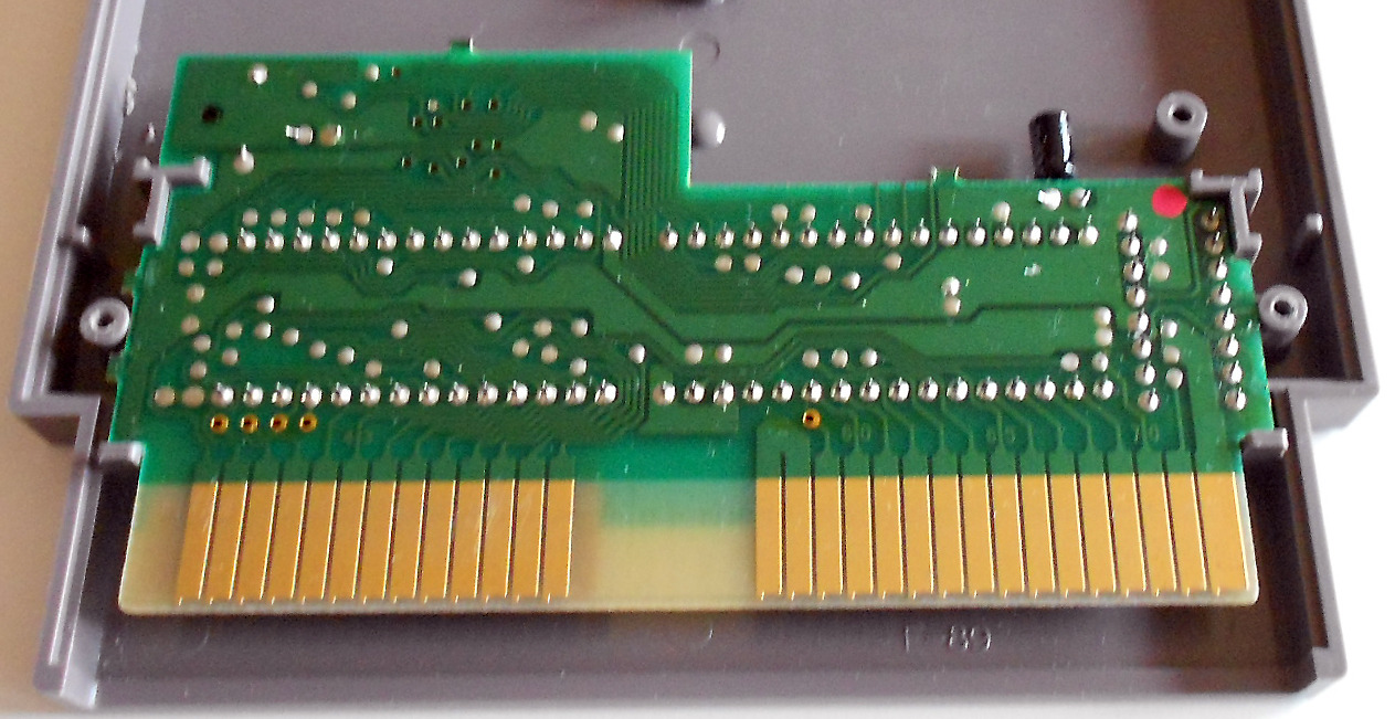

    So despite opening the cartridge and cleaning it the game still isn't working can't see any faults on the PCB only slight concern is one of the cart pins is quite heavily scratched, on a closer looks. Anyone spot anything that is missing or shouldn't be there from the photos?
    Sorry the quality isn't as good as I would like:
    PCB Front:
    PCB Back:
  6. skarpo01
    skarpo01 Peppy Member
    Jul 1, 2011
    351
    What product did you use to clean it? You could try to clean the contact with a special electronic contact cleaner spray or pen, from the picture it seems there is a lot of corrision.
  7. S3M
    S3M Rising Member
    Sep 20, 2011
    63
    Just used a cotton bud to get off any dirty, which pins do you think are corroded? some on the front or back of the PCB or both? Do you have a contact cleaner you would recommend to reduce the corrision? Is WD40 any good?

    Back in the day when I bought an Nes console I would get gray screen on the two games that I had at the time. I ended up adjusting the pins, bending them towards where the cart pins go in and connect so there's better contact

    Any contact cleaner that is specifically designed for electronic components and pcb is fine, one like this for example:
    You just spray a bit on the contact pin, wait a little bit and then gently wipe the excess away with a cotton swap. Usually the cotton will be completely dirty and that is a good sign.
    ps: use gloves you don't want any of this on your hands

  16. S3M
    S3M Rising Member
    Sep 20, 2011
    63
    Gave it a good clean but no luck, the pictures for the pins picks up the light wrong so they look discoloured when they aren't, however a number of them are heavily scratched which you can't see in the picture.
    Interestingly after cleaning it I did get an all yellow screen and then another boot got me a blue, purple, white screen which lead me to this thread.
    http://atariage.com/forums/topic/159105-nes-repair-different-colored-flashes/
    So as I mentioned in my opening thread it might be time to give the 72pin connector a full clean and pin bend, I can only hope the thin PCB board of GQ2 is the main issue here now. But it's concerning only one game is effected by the pin connector. That said the PCB board is smaller than every other NES game I have and makes me wonder if the game had a proudction issue. Was the game recalled in anyway are there reports from the early 90s of problems in NES magazines at the time? This could in part explain why the game is so hard to come by these days in the west?
    I've seen some people mention cutting the lockout chip but that shouldn't really cause an issue with retail games and is more likely to do with the fact that the 72 chip pin to the lockout chip isn't linking correctly.
