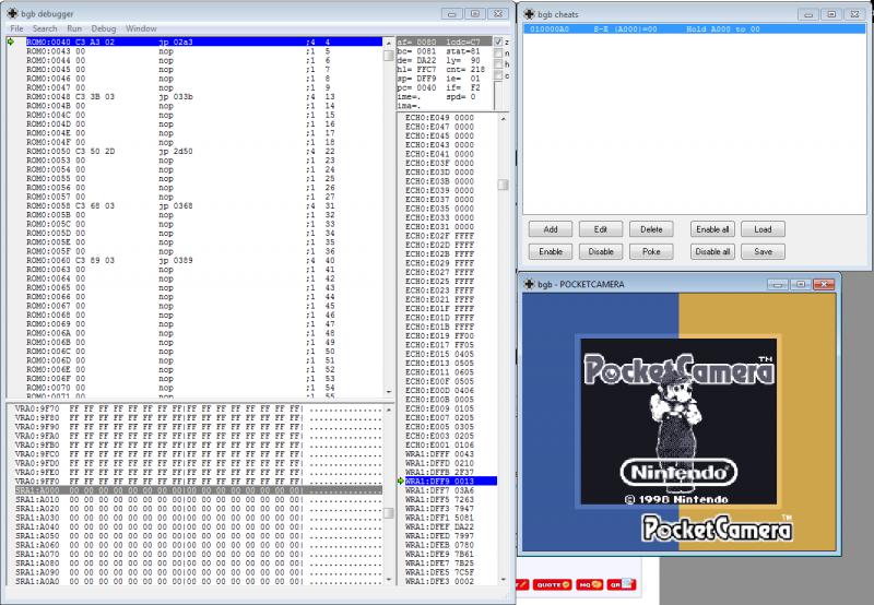

    Yes it has a start up sequence, a part of it being a check on $a000 to see if the camera hardware has reported in ok. Without the hardware it never gets set and thus you get a blank screen.
    I hacked around and noticed the following.
    You can read more about the GB Camera here - http://www.devrs.com/gb/files/gbcam.txt
    Edit:
    Ok i got this to emulate by holding $a000 to 00 via the cheat feature in BGB. On real hardware you could use a Game Genie or other cheat device to hold $a000 also.

    That's awesome stuff :O Hmm, How about I replaced the cam with an attiny and send the start-up sequence?
    EDIT: WOOT. Managed to start-it up! All you need to do is get READ(10), VOUT(14), to GND and you're good to go :)
    Thanks fro for all the info
