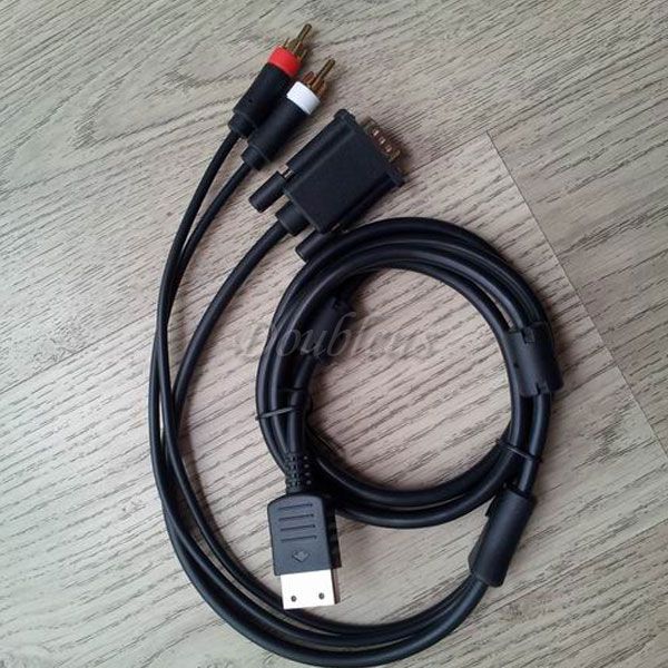

    I've be redefining my setup lately, and I want the best output from every system I have on my TV.
    After looking at VGA box prices, and other alternatives they're still rather expensive. I didn't have balls to chop up my DC for VGA either, so I ordered this cable from eBay.
    The set comes with a L and R audio splitter to 2.5mm jack, which fits into my PC speaker setup I have connected to my TV. Sound wasn't everything to me, as the DC was already through the sound system. Therefore no improvement.
    I've only tried one game with the VGA cable and it was Vigilante 8 2nd Offense. The game looks very sharp in 640x480, I really thought it wouldn't make a difference but it looks fantastic. I could read the signs in the levels, and certain details on the cars such as badges and mudflap labels.
    So far so good, the cable is around $12-$13 might be less depending where you're from. It's well constructed and I haven't noticed any noise on the picture.
    There's my rough review on the cable, I'll add some preview images if people want them.

    I strongly recommend getting a proper made cable. Some of those Chinese clones are simply dangerous for the DC (shorted pins) and most are unbuffered (reduced xompatibility with monitors, especially non-crt ones). I suggest either any commercial ones or cabou's cables that go for a decent price (37 €) and with the connectors you want. Tell him FG referred you.
    You could also build one yourself, or modify the Chinese one you got to turn it into a proper one if you want.

    Good design include a 74HCT244 octal buffer that increases compatibility with monitors and yields increased transmission. Like this:
    Bad designs are straight wired like this:
    Cheap cables might "just work" but the monitor compatibility and signal strength might not be good. Also since VGA is analogous the image quality can be sub-optimal on cheap unshielded wires.
