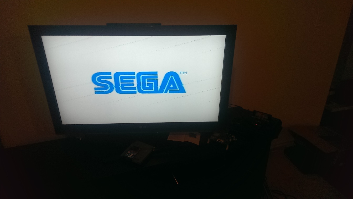

    This picture is running on the base cable into the RCA port on TV, it isn't jumping but it isn't a clear picture there is distortion running constantly on the screen.
