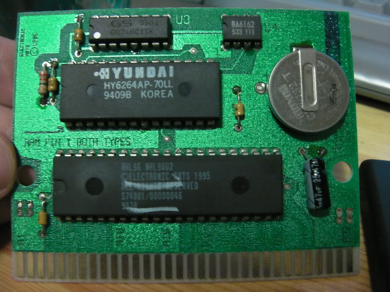

    Hello! I am new to this but I want to burn an eprom to use with with the cartridge NHL 96. I don't have an eprom burner but I will get one soon. The game I will put on the eprom is http://info.sonicretro.org/SoniNeko an I do have the original Sonic 1. Here is a picture of NHL 96. [​IMG]I just want to know what eprom to use and if there is any rewiring to be done. Thanks!
  2. ASSEMbler
    Depends on the type of eprom you use.

    While I also recommend getting a Flash Cart, particularly if you plan to mess around with several games, what you want to do is pretty simple. NHL96 has a 16 meg MaskROM which can be replaced with a 27c160 eprom. However when you program this EPROM you should pad the file up to that 2 megabytes file size. You may be able to get away without doing this I don't know. Something else to note is hacks like these sometimes have problems that cause them to crash or fail on real hardware as they are generally developed and tested on emulators.

    That game will have lot of audio glitches on real HW, so I'd avoid EPROMming it
