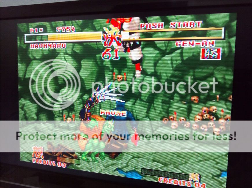

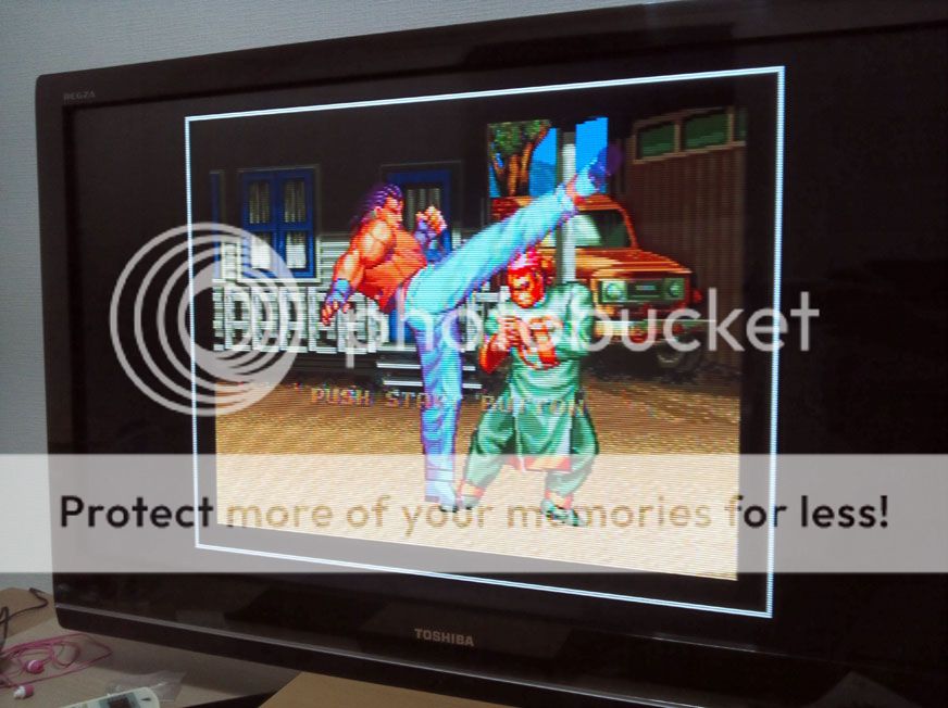

    Well, my junk Neo Geo saga continues. First the PSU was sorted and yesterday the 100 yen joystick arrived and today I found out that even though the Mega Drive RGB cable doesn't fit the Neo Geo, the Mega Drive composite cable does and I had one of those lying around.
    So on booting up every game I have for the Neo Geo I get the below garbled screen with no audio or anything. This is before the Neo Geo splash screen should come on.
    If the game comes on it's glitched as below.
    BUT, if I go in to the Neo Geo memory card screen then exit that, the game will boot fine.
    however all is still not well. While the games are now fully playable there are some small graphical glitches on any sprite that is manipulated such as rotation, scaling or distortion. Sprites that don't have any manipulation seem to be fine.
    What could be causing this problem? Is it the BIOS or could it be an actual issue with the Neo Geo's CPU?

  3. Yakumo
    I'm afraid I can't get an official PSU. They're so hard to get hold off so I'm stuck with the one I'm currently using.
    I'm not sure if it is the PSU though.
    Take a look at Samura Spirits. When the screen is zoomed in the image is OK
    But when the screen zooms out it looks like crap. A PSU wouldn't have this sort of effect, would it? I'm not sure.

    The first photo indicates that something was something on the 68000 bus wasn't making connection so it crashed. When the games start (and run without crashing) the connection is fine.
    The RNK2 distortion looks like damage to a custom chip, but since it's gone in the other pics that's not it.
    The SS distortion is caused by a bad connection to the ZMC2 chip inside the cart, or because the ZMC2 isn't functioning correctly.
    My guess is that your power supply is insufficient which is leading the chips to act up. (+ connector needs cleaning).
    When the power supply doesn't have enough current capacity the voltage drops, when the voltage drops chips slow down and cause glitches.
