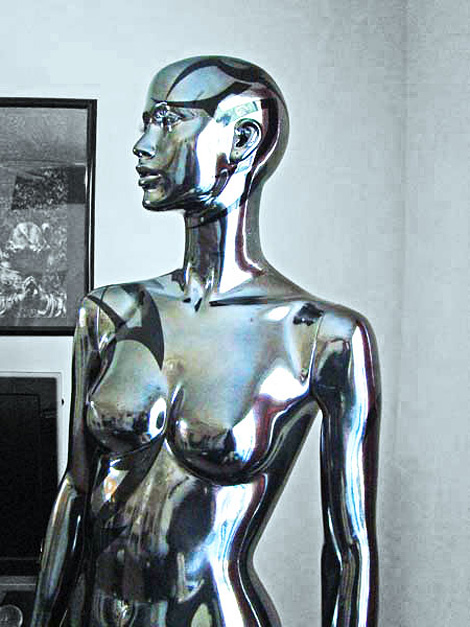

    I don't know if this helps, but I found this company that sells chrome sprays and films as well as other kind of painting effects that may do the trick.
    Hope it is useful.
    (Some of their products)
  3. HEX1GON
    Ah that stuff is similar to tint or vinyl wrapping. They're good for large surfaces but small areas like badges might be difficult to do, considering most of them require heat to stretch. That is a likely a solution though that I never thought of.
