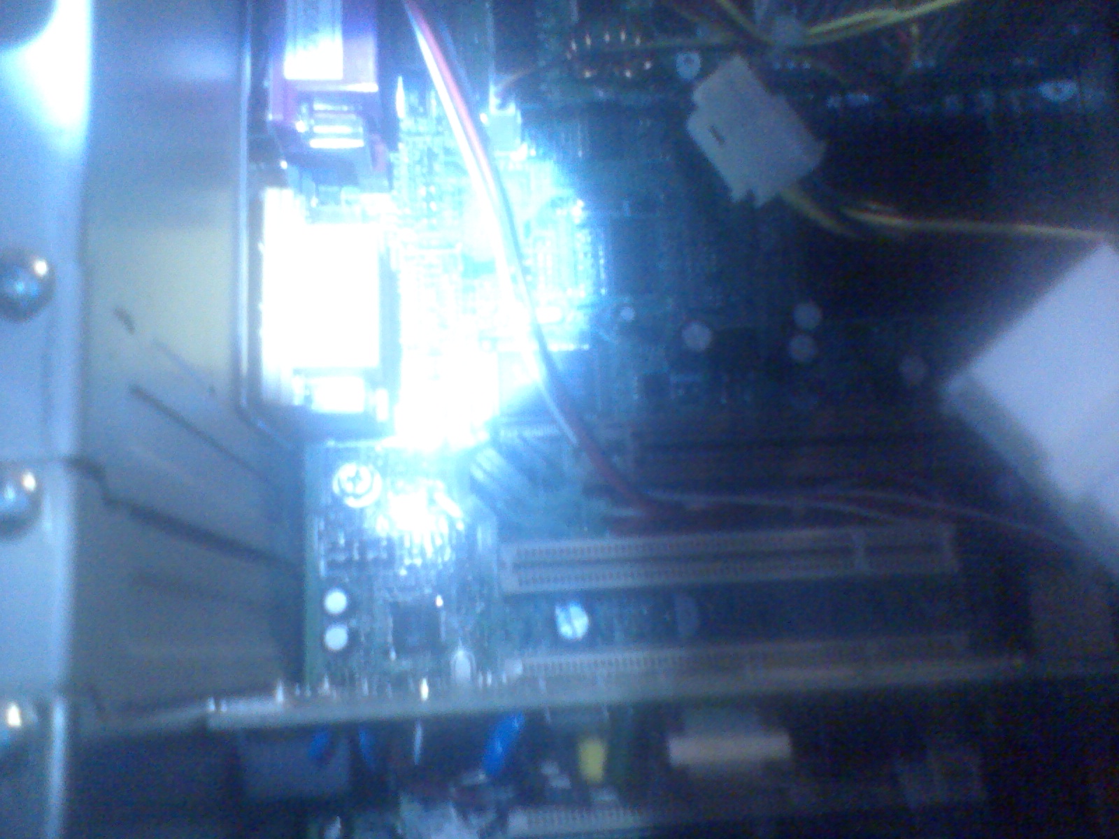

    The AGP Slot is the length of an AGP Pro, but has only the big.....Line thing(?) at the right

    On the AGP front, it's a case of RTFM. What's the board? Look it up, see whether it was AGP, 2X AGP etc. The XP 2000+ is from 2002, so it's more likely 2X or 4X AGP. Likewise, see what RAM is compatible in the manual.

    This is the best picture I could get of the AGP slot on the motherboard, which is a Pheonix M7VIG. It doesn't match the website's picture. I'm guessing my motherboard is an OEM Version, because the computer is prebuilt (Although it appears to be made from off the shelf parts) by Systemax. The RAM is reporting at PC133 and DDR1. The caps appear to be working fine, because the motherboard is working perfectly, and there are absolutely no traces or hints of cap damage or leaking.

    Update: I was looking at the wrong motherboard variant, It's using an AGP 8x
  16. retro
    That's actually a Biostar motherboard. Phoenix is a BIOS. And there's no such thing as an OEM version of a motherboard - a motherboard is a motherboard.
    Anyway, the board only takes DDR266, so if you're using DDR400 it'll probably clock down, but might fuss. And it's 4X AGP. If you meant it's actually the M7VIG 400, it'll do up to DDR333, but still 4X AGP. If it's the M7VIG Pro or Pro-D, it's DDR266 but 8X AGP. Technically, it's an Award BIOS, but Phoenix took them over.
