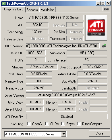

    Yo, AssemblerGames, I want a new graphics card and I'm a complete noob when it comes to upgrading my PC so I kinda help here.
    I took a Windows Experience Index test which gave me a score a 2.9 out of 7.9 in the Graphics category. Basically what it meant was that "A computer with a base score of 3.0 can run Aero and many features of Windows 7 at a basic level. Some of the Windows 7 advanced features might not have all of their functionality available. For example, a computer with a base score of 3.0 can display the Windows 7 theme at a resolution of 1280 × 1024, but might struggle to run the theme on multiple monitors. Or, it can play digital TV content but might struggle to play high-definition television (HDTV) content." What I have now can't even fully run Aero, apparently. =/
    From what I read is that while I have 2GB of RAM, it shares 639 MB for graphic processing. So if I'm right, everything in my PC will slow as it shares RAM, so to remedy this, a graphics card will be needed to handle the graphics on my PC. I've also learned that purchasing and utilizing a decent graphics card will also seriously improve video playback, recording, capturing, production, and rendering, which would be fuckin' awesome, especially for what I do. I always have to deal with the slowness of processing video and previewing whenever I put together images, text, and video pieces for my documentary or other projects, for example.
    I've also read that basically if RAM is shared for video, it's likely that the graphics card is integrated, meaning it can't be upgraded. However, there seems to be a particular slot in the inside of my PC. Photos:

    And here's what graphics card I have, which happens to be "ATI RADEON XPRESS 1100 Series."

    With your setup, you are better off investing in building a new PC/having someone build it for you or just flat out buying a new one.
    CPU and GPU equally share a lot of the burdens when it comes to games and video processing.
    However, you can get a new GPU (if your Power supply is sufficient of course)
    And it will give you a performance boost, just not as much if it were in a new system/non bottlenecked system. (I used a Pentium 4 system on LGA775 for quite a few years with an Nvidia 8600GT that I installed a few years in that was heavily bottlenecked by my other components)
    A good modern example of this is the custom PC I built my brother.
    Initially it had an 8800GTS 640mb, which I later upgraded to a 450GTS 1GB .
    Now because of my oversight in choosing a motherboard for his pc, it had a relatively low HyperTransport speed (It's an AMD system, so HT is basically the equivalent of FrontSideBus, or modernly QuickPathInterconnect on Intel systems) of 1000 mt/s. The Cpu (an AMD Athlon II X2) is rated for a max of twice that speed of 2000 mt/s, which slows down the speed in which the CPU can get all of it's communications to (commonly the Northbridge first and then to )all of the other components in the PC including the GPU.
    You can guess what happens after. The components are being bottlenecked by the motherboard, thus keeping everything else from running at it's maximum potential.
    In perspective, the 8800GTS 640Mb I took out from the system I temporarily put in my the PC I was building in early January this year because of money troubles (which is an LGA1366 X58 system). The 8800 GTS in my system was performing above the 450GTS 1GB in my brother's system because there was no bottlenecking.
    And that's a big deal, the 450GTS is far and away , a much more powerful card than the 8800GTS, a GPU that is more than 2 generations behind and released nearly 5 years prior. (8 series, 9 series ,100 Series*same as 9/8 series*, 200 series, OEM 300 series *same as 200* and then the 400 series which was all new like the 200 series)

    Based on your power supply (Which is rated for 19Amps on the 12V rail)
    And your resolution. A 300W PSU (especially an OEM one, which are usually not of the best quality) You'd be lucky to run an 8600GT like I did on an 300W PSU.
    Luckily you can get this

    If you're serious about that power supply. PULL IT THE FUCK OUT. Bestec are notorious for being shit.
    It's rated for 300w but It couldn't put that out on a good day.
    It had a shit 5v standby circuit, caps would go bad after a while (They used the caps that were manufactured with the stolen & incomplete recipe (Google capacitor plague for more info) and it would jump from 5v to 12v and blow just about everything connected to the power supply.
    I'd suggest getting a whole new pc in general if you can afford it. Atleast 4gb of ram and a dual core if you're editing video. I went from a 3ghz P4 to a slightly slower dual core and my rendering times decreased so fast.
