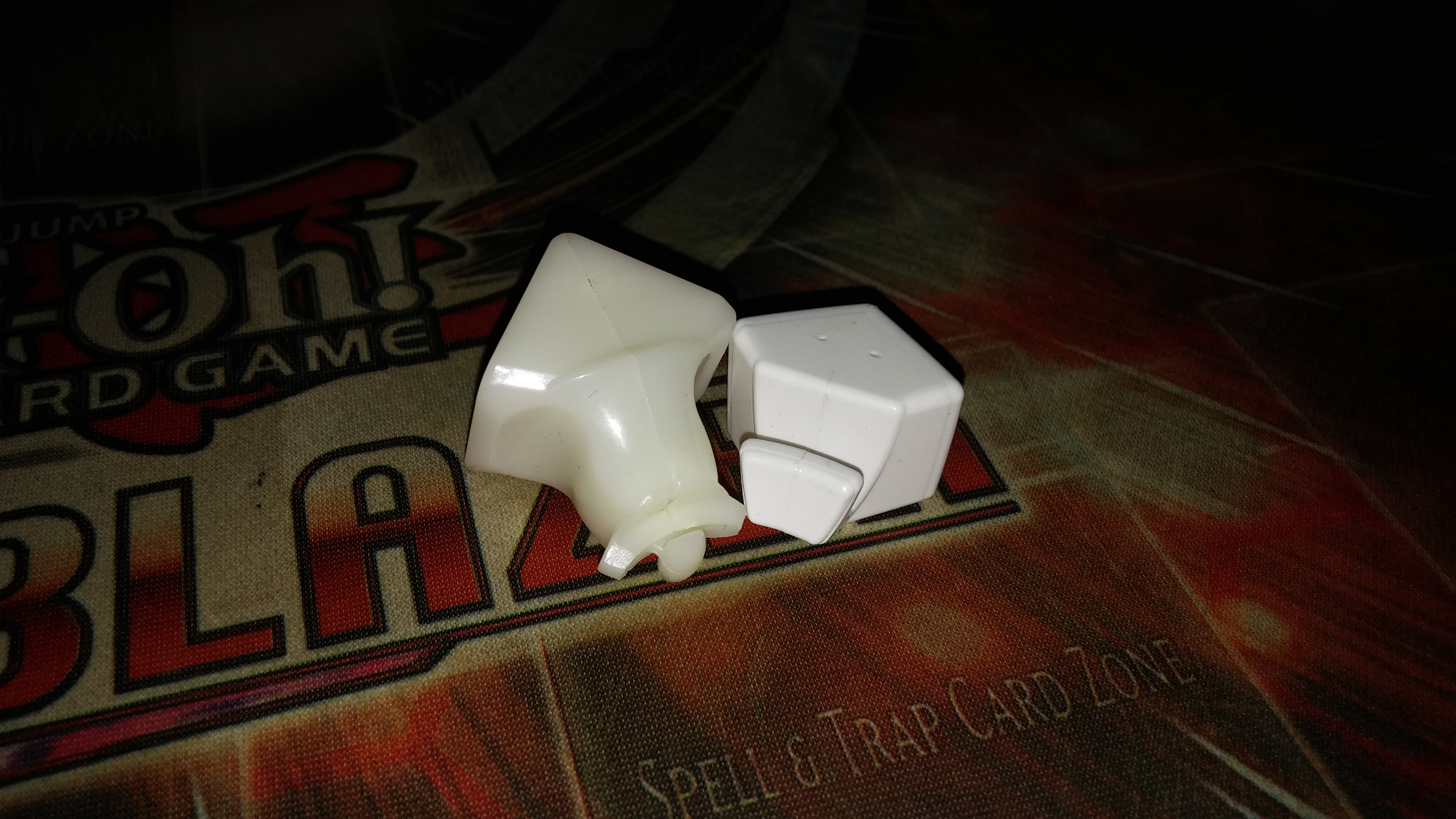

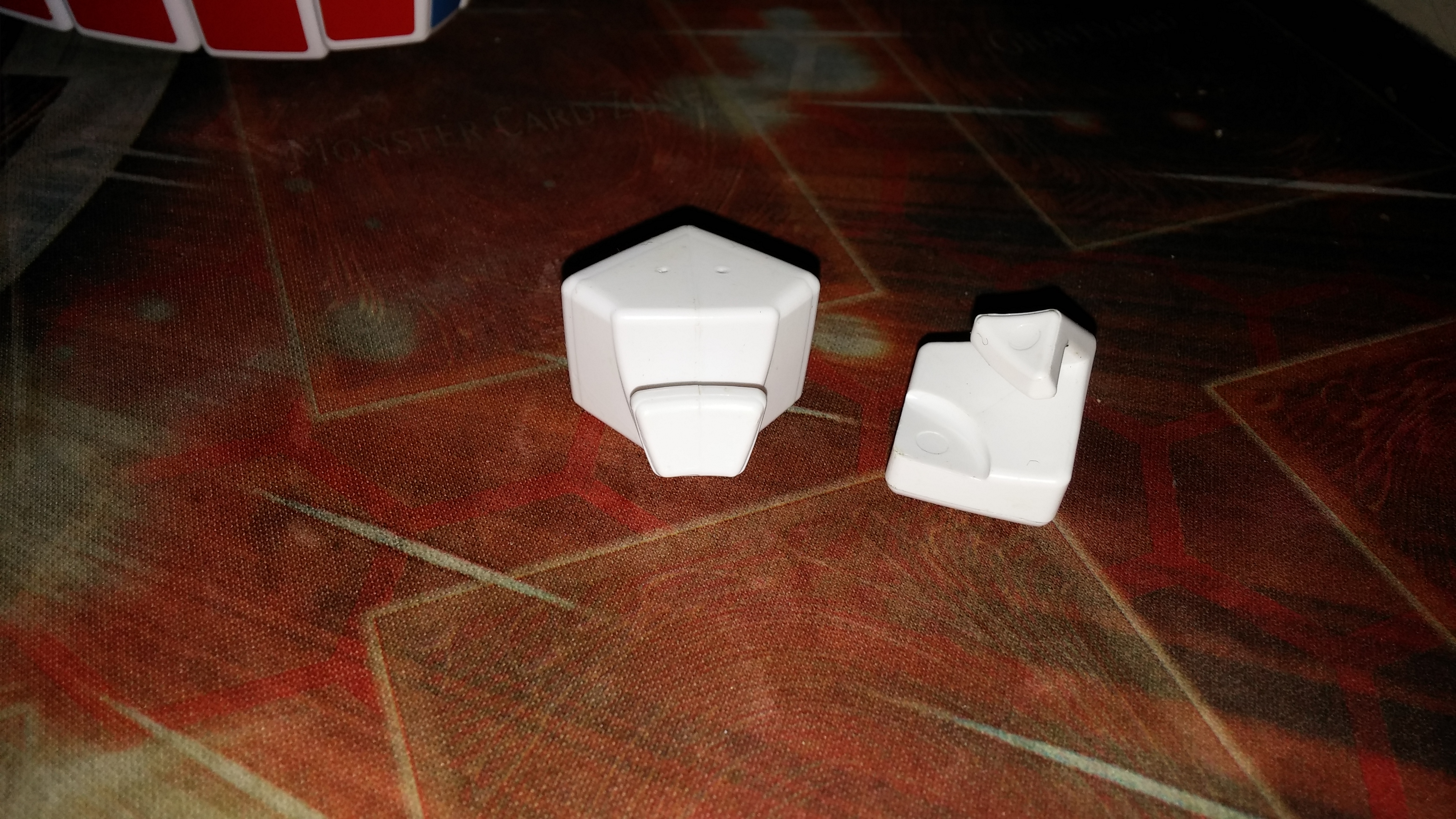

    There's a lot of plastic types out there as well but generally speaking you will find plastic that has colour like such. This plastic is essentially what undyed plastic looks like (It's usually an off-white colour - sometimes described as "milk yellow". Sometimes it's also softer so its easier to remove defective spots easier as it's easier to cut through - but the colour is usually the same).
    Here's an example of plastic with a white colour for dye looks like for comparison
    And both next to each other just to be sure you see how different they are

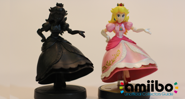

    -Can sometimes be dye test samples (there was a completely black plastic Peach Amiibo - this was a real prototype)

    -Just because it uses the undyed plastic does not make it a prototype (the picture I took of that part is a production mold part using this plastic. My other hobby uses it for "limited edition" batches for fun for collectors)

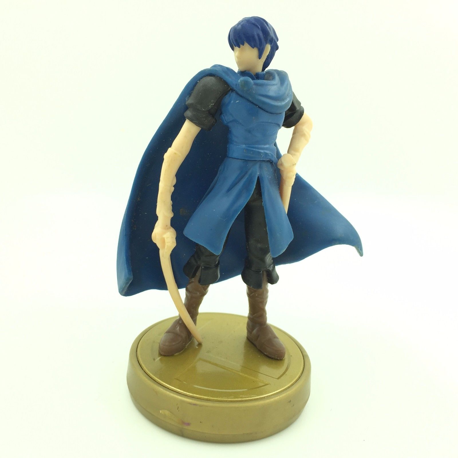

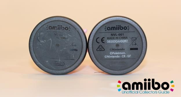

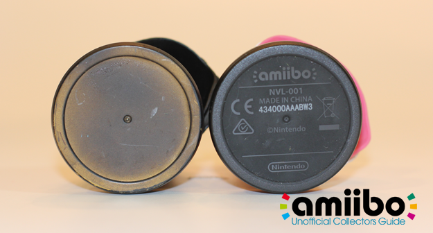

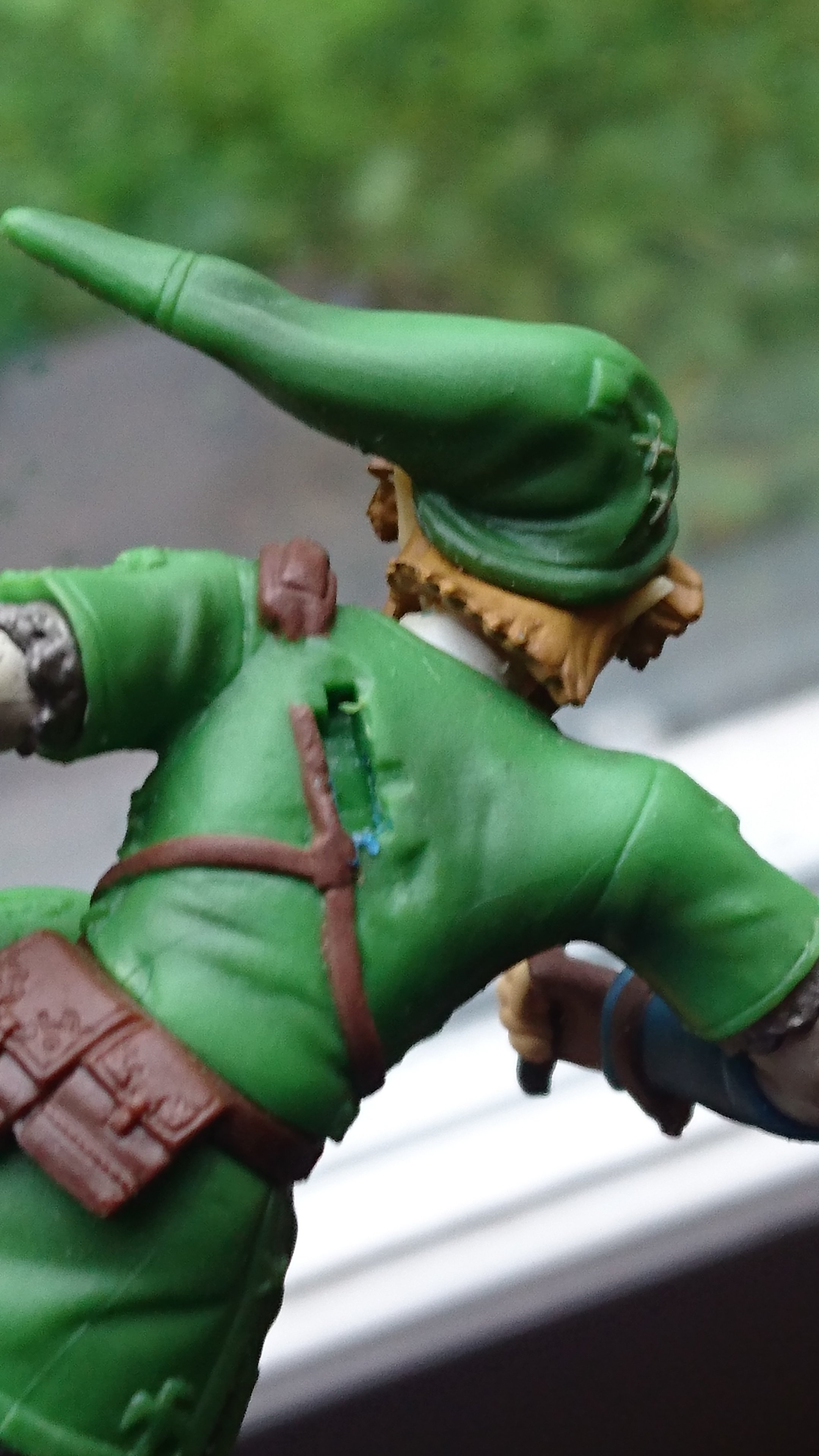

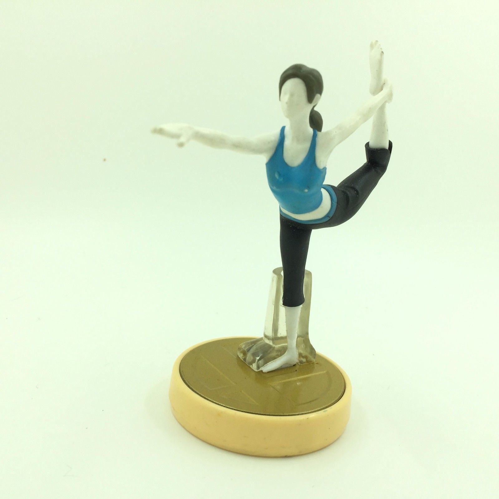

    Here's some images of defective Amiibo from the production molds. Note the pale off-white colour is not shown in these as I have not found a good enough image of it on Amiibo.
    Here are some examples of what sample/test Amiibo are like.

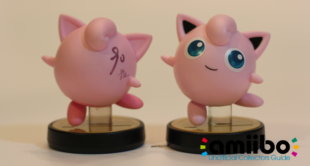

    On the Jigglypuff, note the feet colour. Despite having a standard stand that's defective, the dye used for the base pink colour is different from the top half of the model. This would be a defect normally, but in this case the top half was fitted onto the bottom half for a QA check. The bottom half is in fact a part of an earlier batch of some sort despite the top half being the production version. It's common to do this as they usually do not change the assembly aspect, but instead change the visual aspects.
    So somewhere out there, the top half of this model exists and is separated from the feet.
    This is the Black Peach sample I had mentioned earlier.

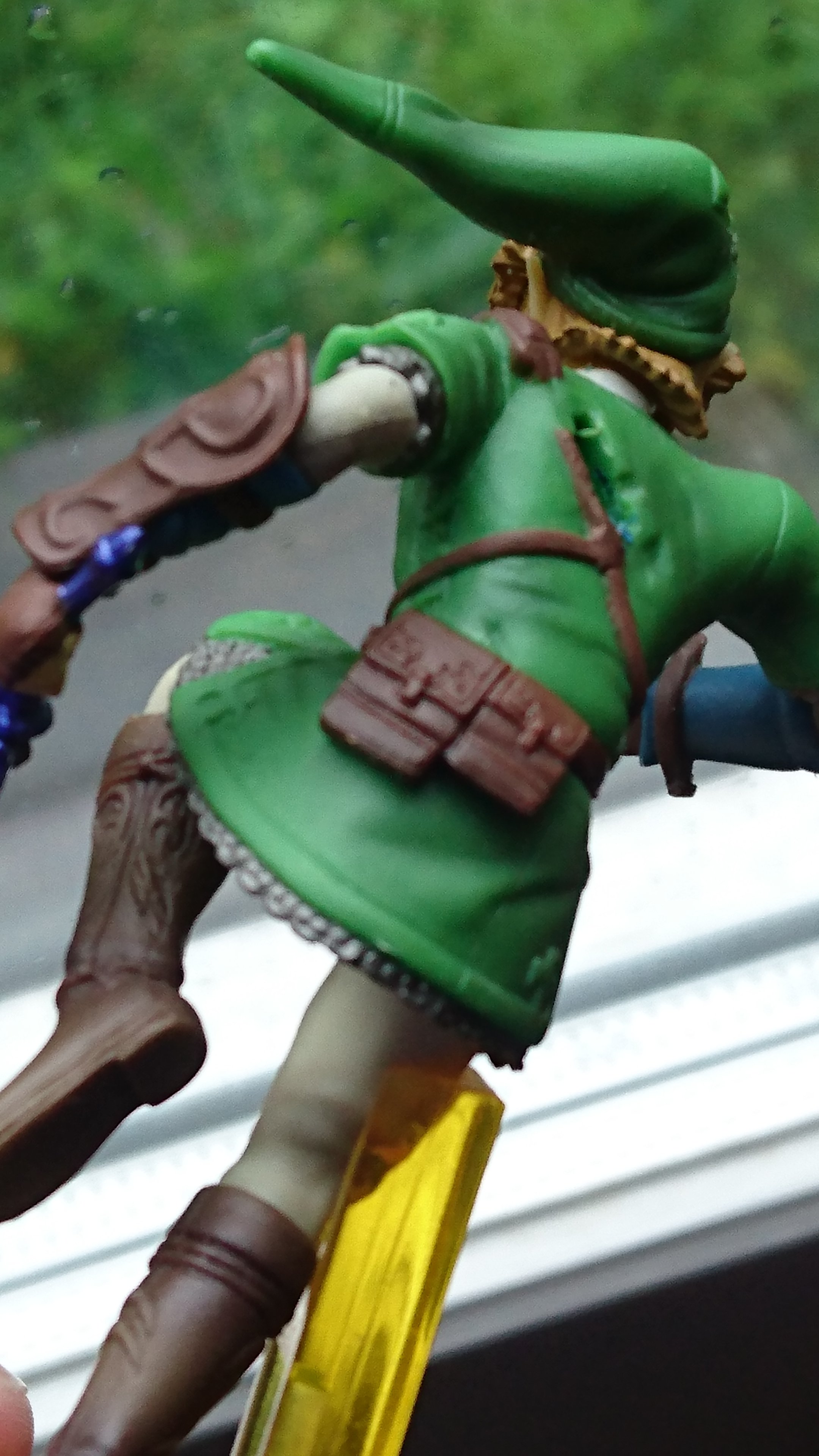

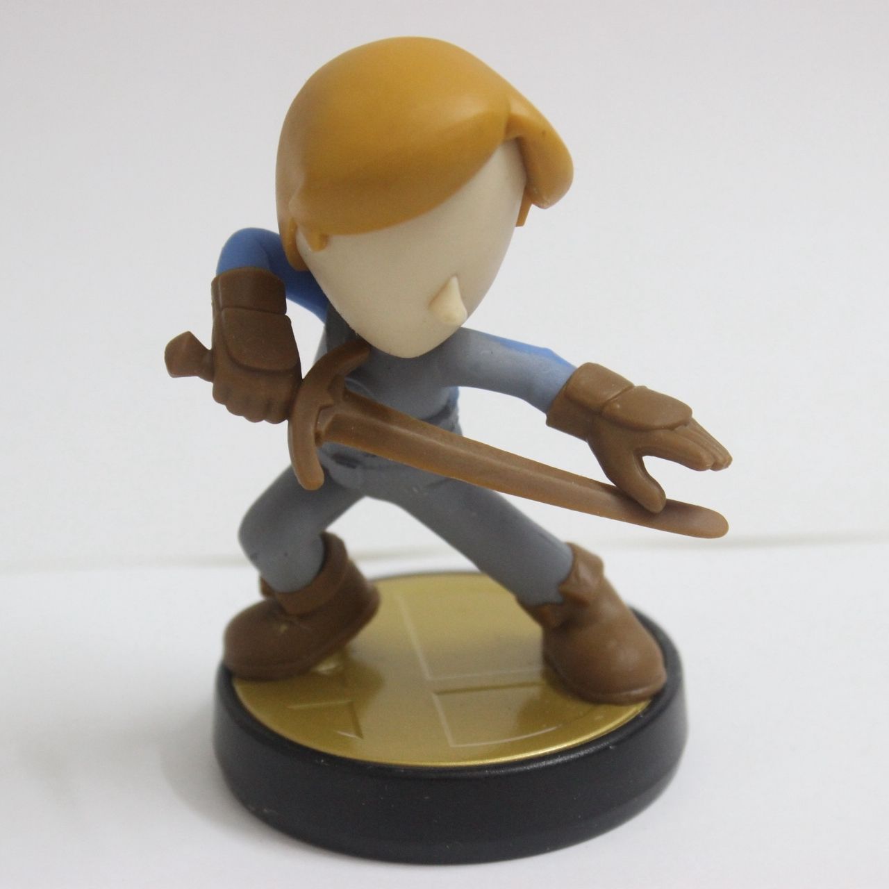

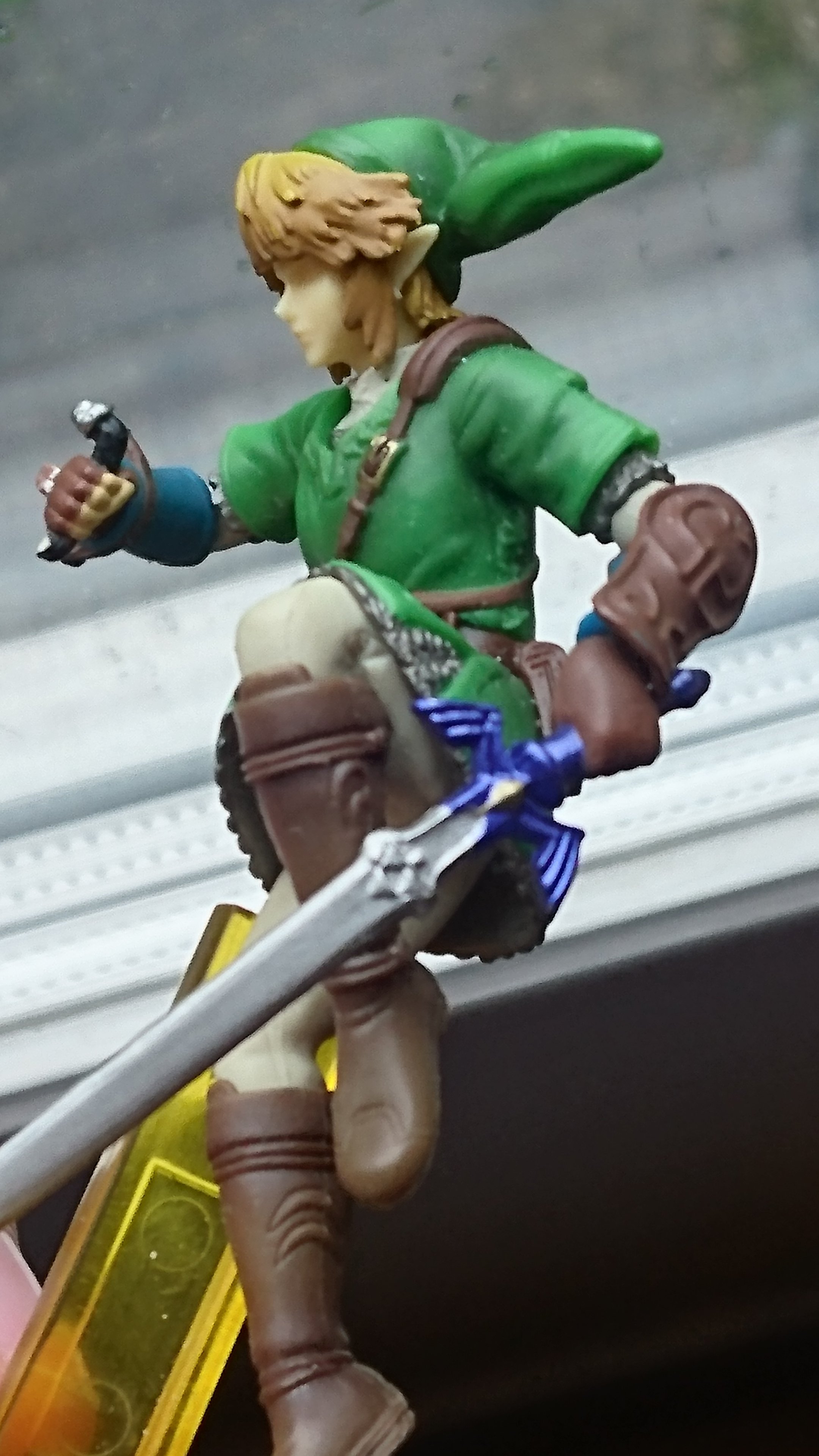

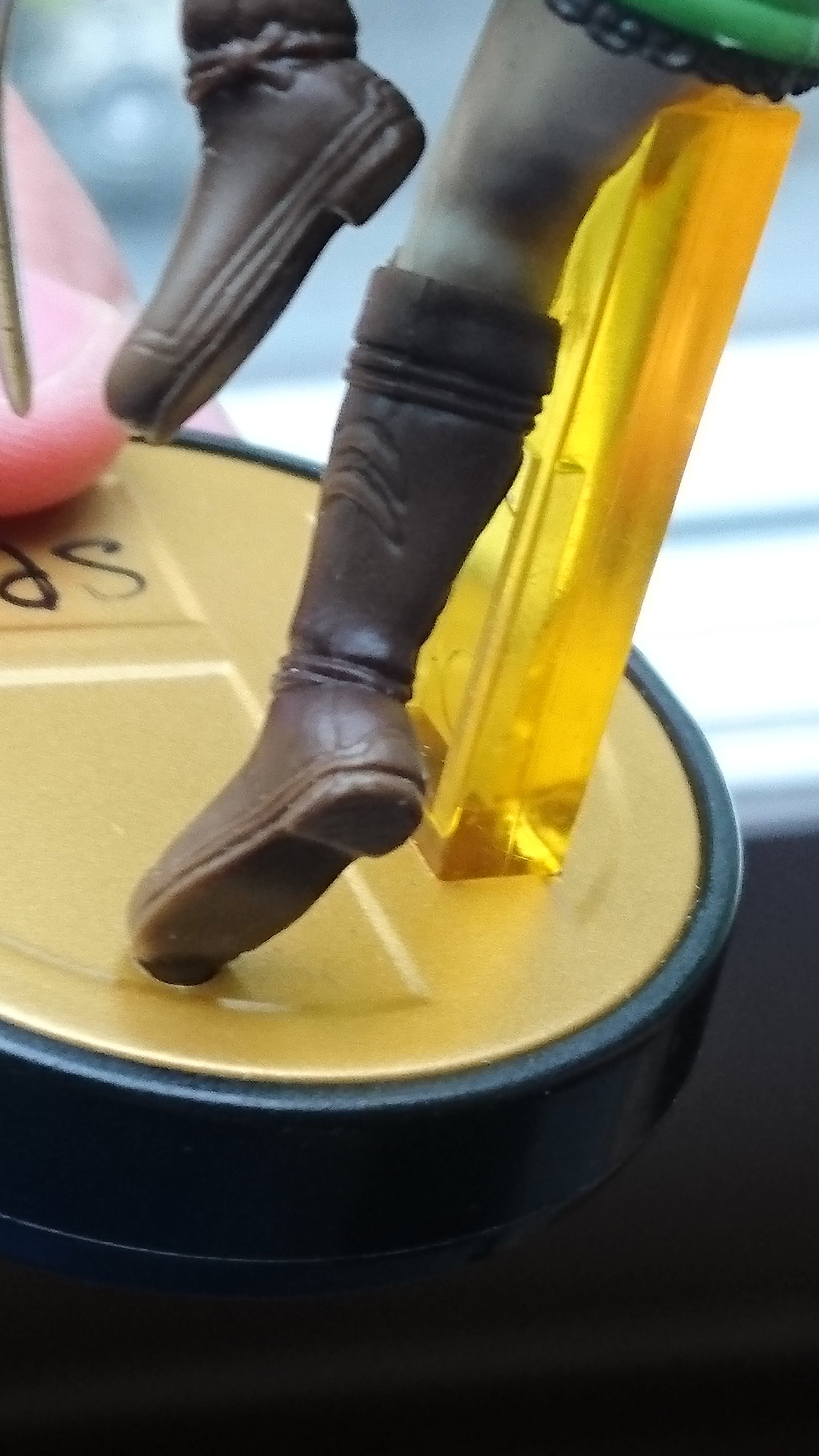

    So the Link Amiibo I have would be categorized as a test run sample rather than prototype.
    But can the info / lack of info at the bottom of the figure determine whether it's from around the final mold stage or from a stage where it's ready to og but has defects? Does it make sense that prototypes don't have info underneath, samples are sanded and defects still have the info?
    Those Marth, Wii Fit and Mii amiibos are the ones I was talking about. They kept being listed as they sold and finally stopped selling. Leaves me thinking they were produced to look like test samples.

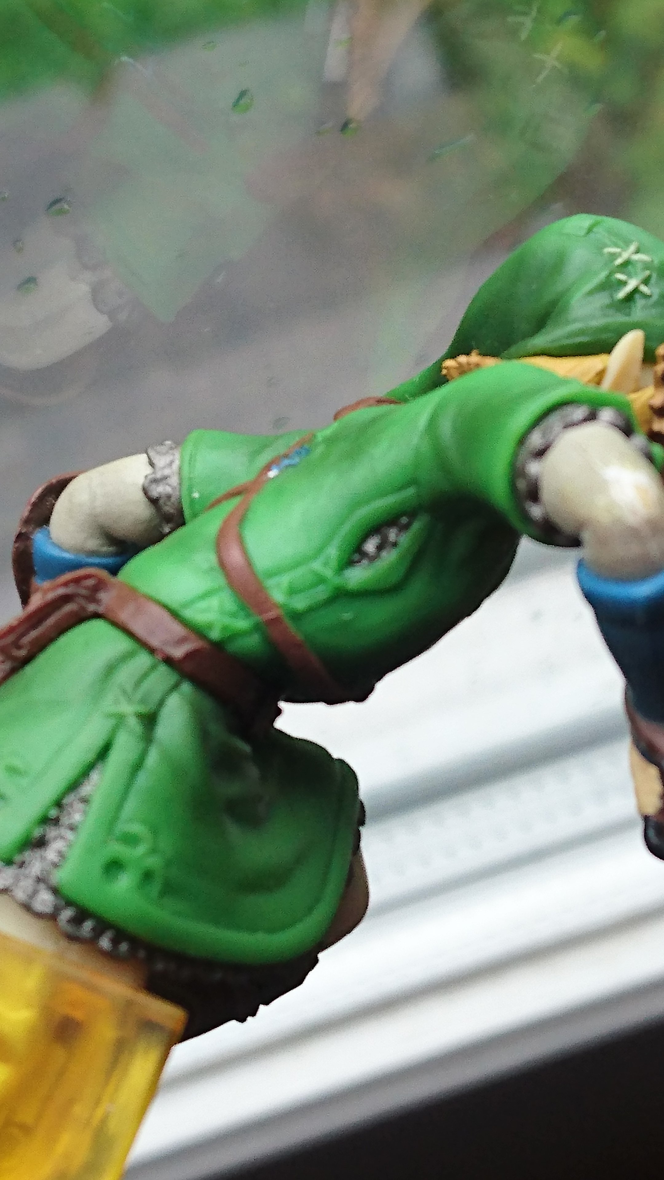

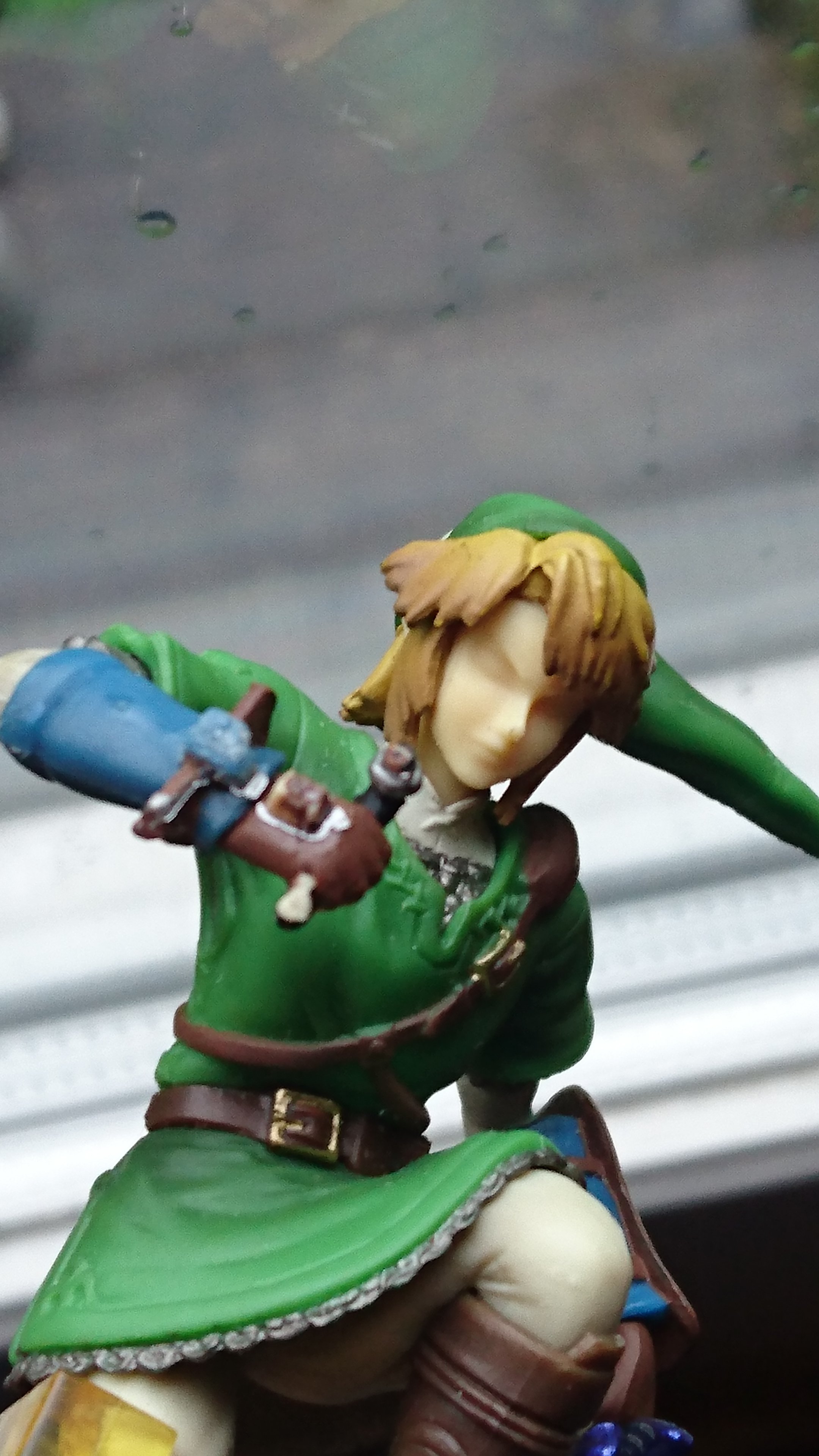

    It's very difficult to say what is and isn't since you have to know what mold was used for this. It's very likely yours was just a defective model but it's still possible that it was a test model of sorts.
    I'm certain yours is from the production mold and just a defective run one but I cannot be completely sure. They have value in their own right since they weren't supposed to leave the factories and instead be destroyed, so it's not like they don't have their own value.
    If you could take some more pics to show the details that'd probably help. Top bottom left right front back. I just want to see the details.

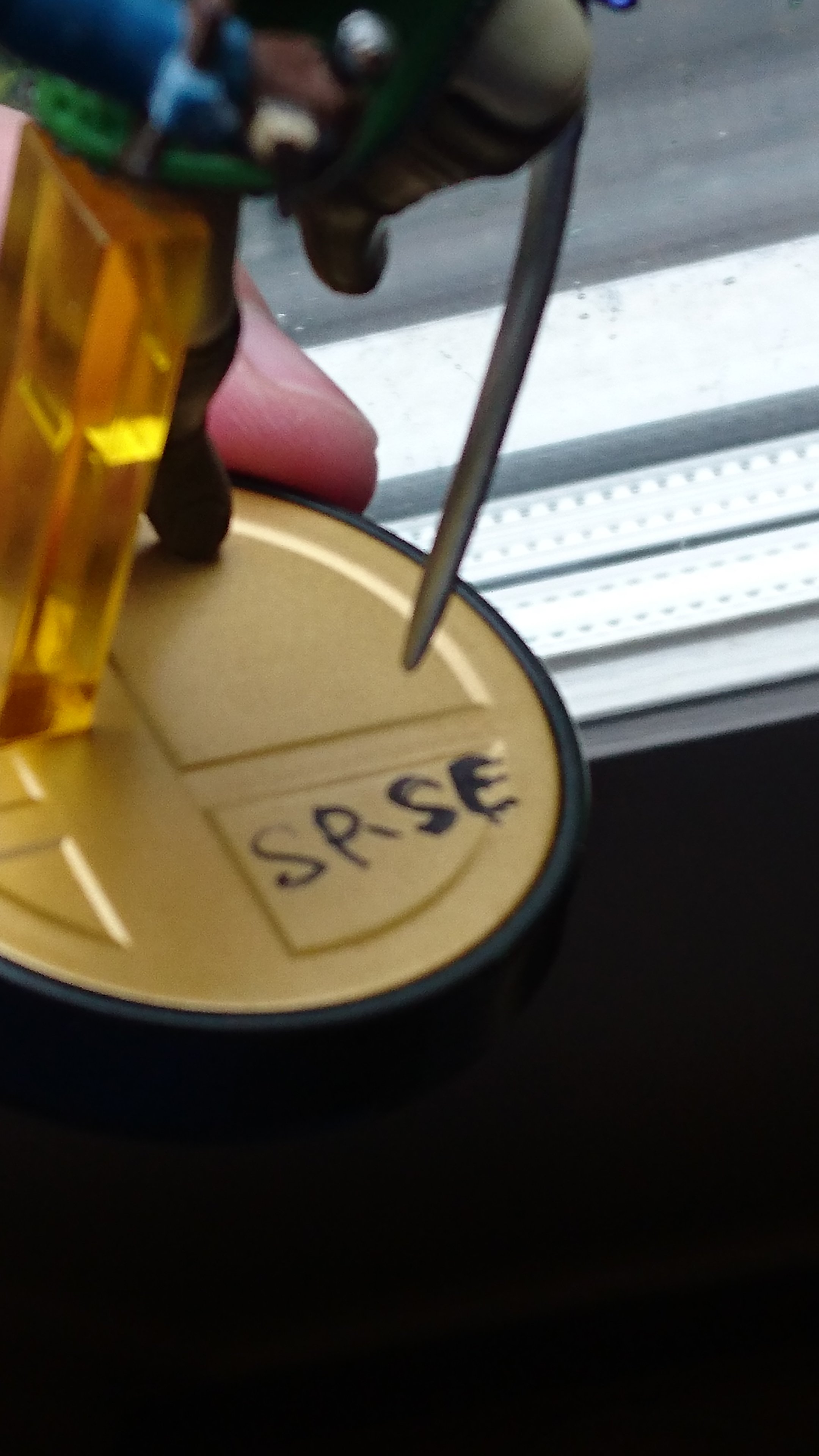

    Ok. I don't have a released Link Amiibo to cross check for differences, but they look identical from pictures, so yeah, I bet it's of a very late / final mold as you say. And good to know it's got some value, as I'm considering letting go of it to finance a trip to the US.
    Gotcha. I'll try and take some more pics tonight.

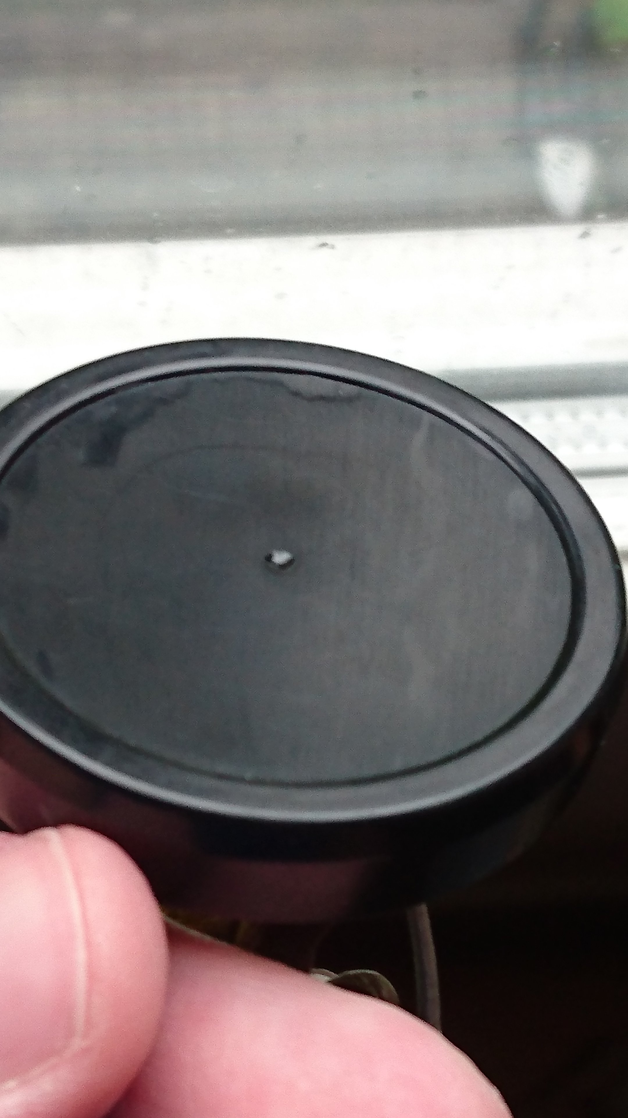

    Sorry for not getting images up earlier. I've been a little busy. Not the most HD pics, but they were taken in a hurry. :)

    Sadly no. I haven't handeled any other Amiibos, but the figure is very light weight, so I assume there's no chip inside.
    I don't know anyone who owns a WiiU, so I can't test it either. But if this was a pre-production unit, only made for display, I guess there was no use for a built in chip before producing the actually working E3/kiosk demo units.
