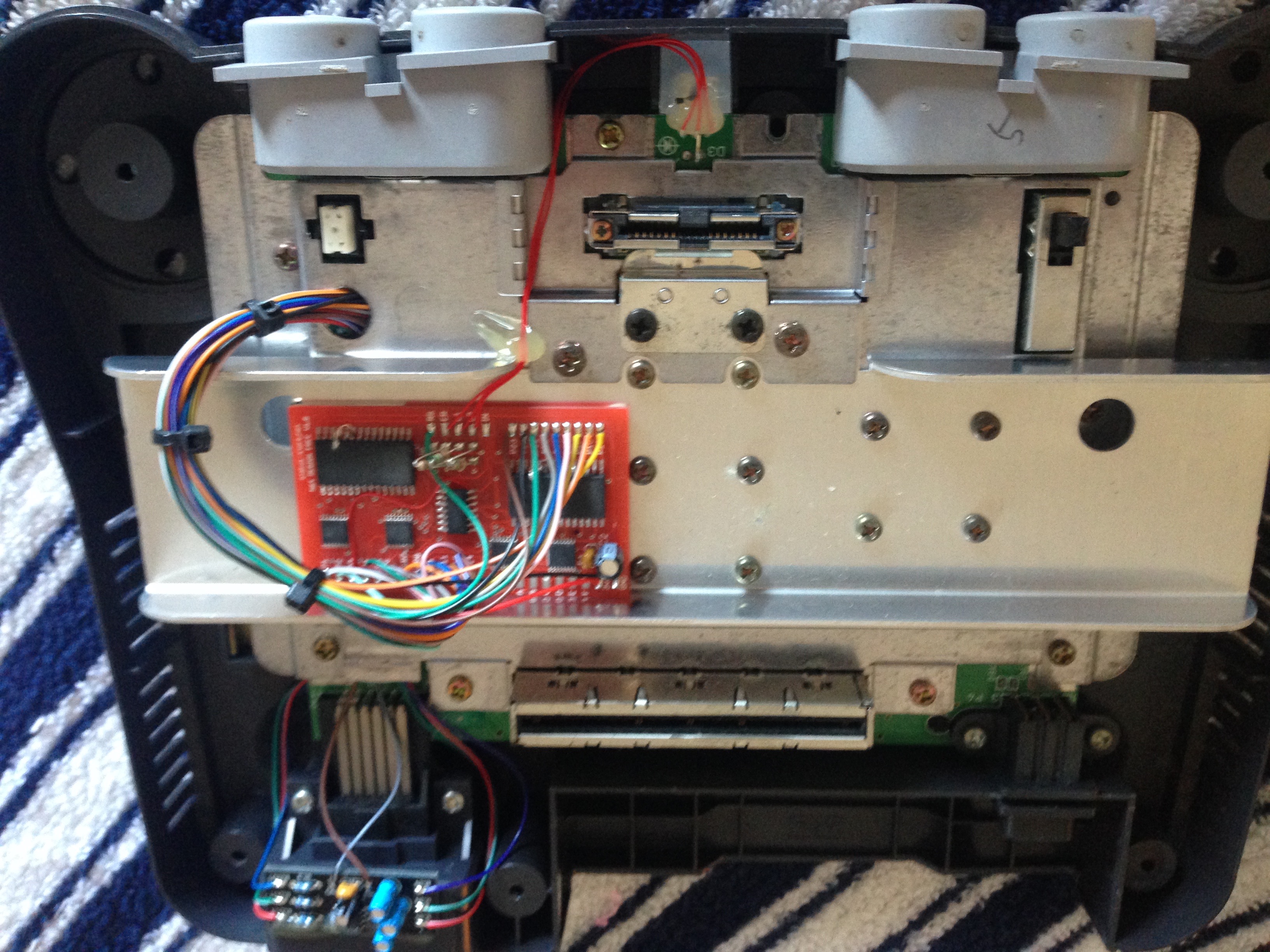

    Can you open the console and post some pictures?
    Thanks.
  19. Ninjastar
    Ninjastar Active Member
    Dec 2, 2014
    27
    Sorry about the late pic post of the internals. I was a bit unsure about taking it apart.
