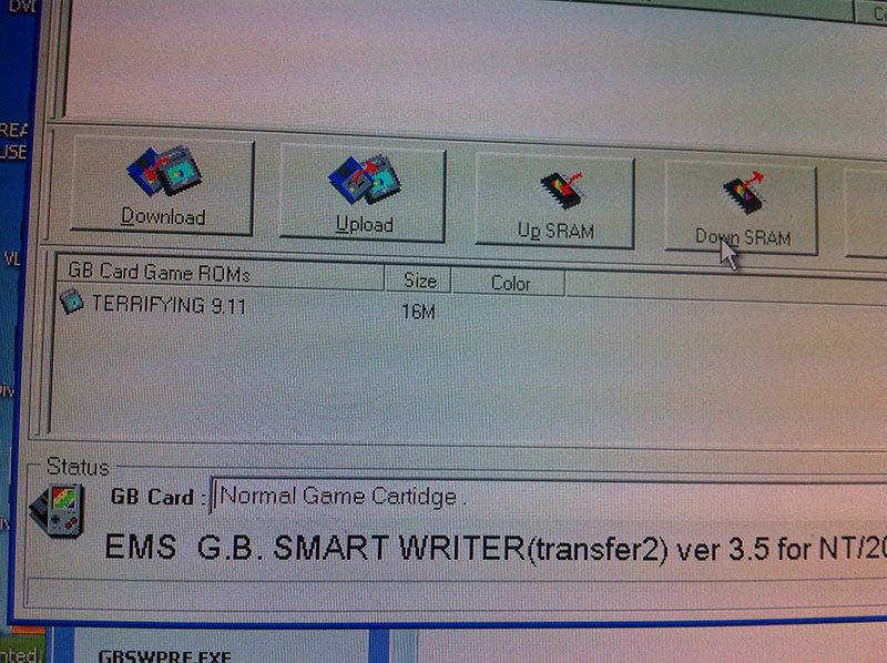

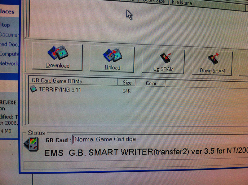

    When I plug the cart into the transferrer and set it all up, GBv2.3.5 correctly identifies the game (most of the time it reads as 64K, but every now and then it will show up as 16M).
    No matter what though, it *always* rips to a 64K file, which (besides being clearly too small, given the presence of the game's opening movie) gives an unknown opcode error when I attempt to open the resulting .CGB file in an emulator...

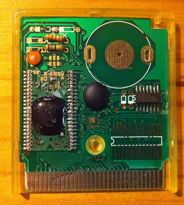

    Pirate carts occasionally have copy protection on them. For the dump you get, what are the contents of it (using a hex editor to look)? Also, do you have a picture of the PCB?

    Well, here is a picture of the PCB:
    I dunno if you need it, (I'm totally inexperienced when it comes to dumping carts), but the text on the black chip reads:
    74HC00D
    866430Q
    Hnn9314PD

    Would I be right in thinking that is a genuine Nintendo cart that has had the EPROM chopped off and replaced?
    EDIT: Nevermind, quite obviously not a genuine cart.

    The 74hc00 is a common chip containing four 2 input NAND gates. That can be ignored. The blob in the middle is probably a form of MMC and that leaves the large board with large blob on the left side containing ROM. It has 44 pins and could be a 16 or 32Mbit ROM which would match your reading of 16Mb when you tried to dump it. If you know someone that has an EPROM programmer and has a mean and skill to dump safely, maybe you could check with him?

    I believe I am looking at this correctly. The header of the ROM says it's only 64KByte. Is there any way to force a size in the program?
