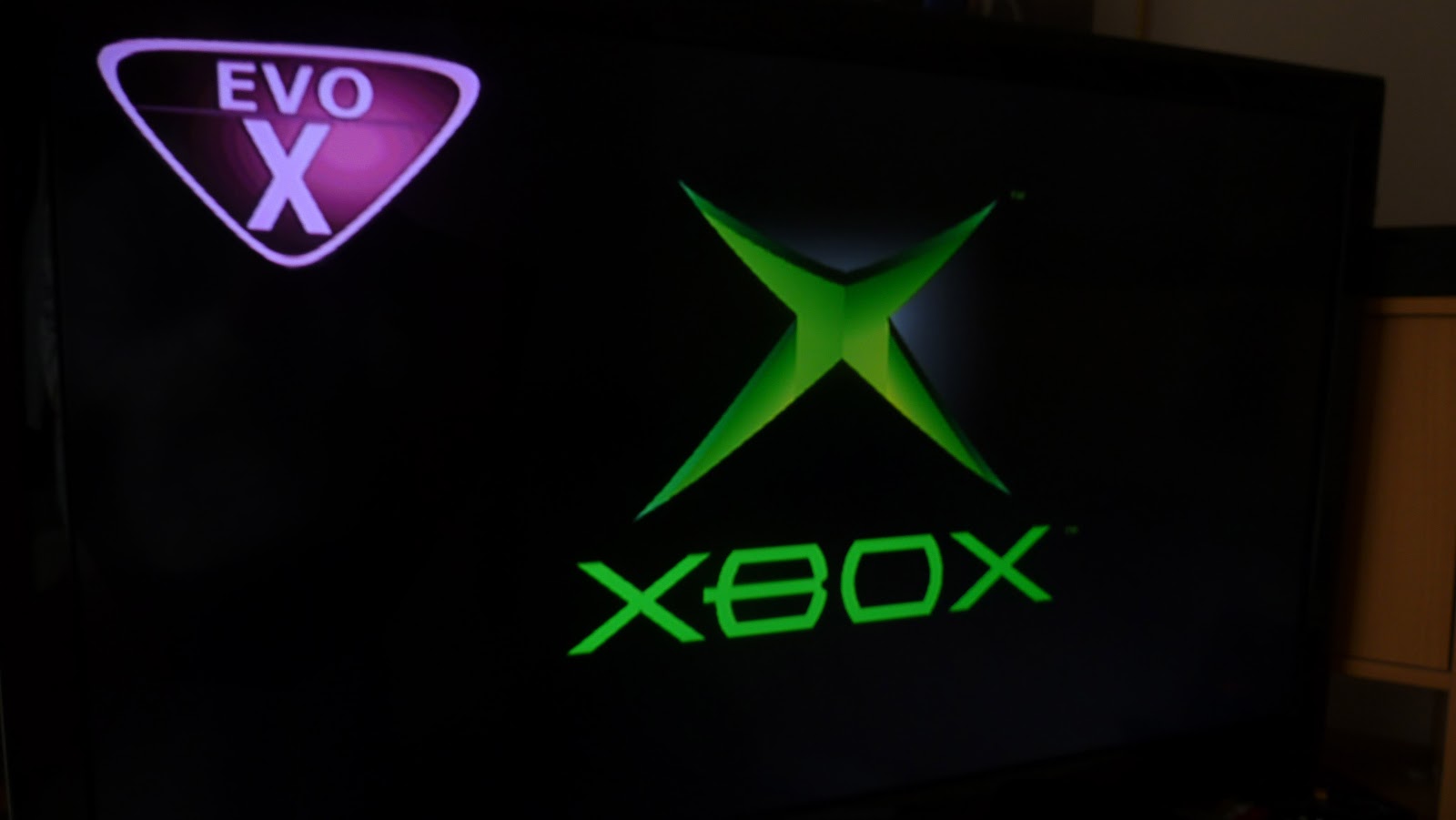

    Nice find :D I'm kinda my local modding and fixing console guy so i have rewired to many LPC ports for my liking that i almost don't need a guide for it >__<' but yeah between that and the v1.6 inability to run software like chimps modding the v1.6 xboxs with anything more then a softmod is kinda a pain so your lucky you don't have to. :p Also what is this blue xbox logo your talking abort?? normally with thease modchips it's a pink triangle or the microsoft logo text gets replaced wtih xecuter ... unless you mean this which i don't thing is even ment to be on that chip :S so a BIOS dump may be something to upload if you can manage it...
