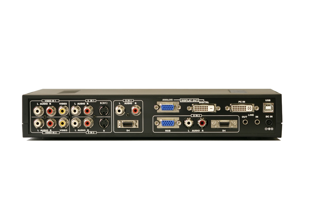

    I can't find any info on the inputs of the xRGB3 or the xRGB Mini Framemeister. The put put of either doesn't matter but I would like to use s-video or scart RGB and possibly VGA as well for the DC but I can live with scart RGB upscaled. I have a chance to get the xRGB Mini Framemeister for $315 shipped or the xRGB3 for $290. If someone could help with which inputs are allowed for each and even your experience with each. I would pefer to use scart RGB PAL cables as they are cheaper and seems to be much easier then Japanese scart RGB cables. Here is what I am looking to hook up and the video cables I have to use

    As far as I know, the Framemeister will do virtually anything the XRGB3 can do, but it's smaller, it has better support for HDMI (the XRGB3 only has DVI, and certain video modes aren't supported over DVI), and it has some new features. If the difference in price is only $25, I would definitely go for the Framemeister. My knowledge on these devices is somewhat limited, but I'm sure there are others who can give a more thorough answer.

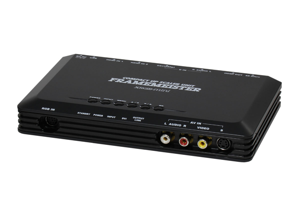

    I know the Framemeister has RGB (21-pin Japanese), S-Video, composite, and D-terminal (component) inputs. The RGB input uses the Japanese pinout, so you'll need an adapter to use SCART cables. It doesn't have a VGA input. But you should ask Yakumo about this - he's an expert on the subject.

    There's only one real reason to own a XRGB3 and that is if you want to use VGA for something such as the Dreamcast. That is the only weak point about the XRGBmini Framemeister. Other than the lack of a VGA port the Framemeister is far more stable, gives a better image, more compact and much easier to navigate plus it's far easier to set up in to English and update.

    i love my mini, for the reasons many said prior - there's workarounds for the DC VGA too, looking forward to the Kenzai on this very forum, heh. for everything else i'd go RGB - most of the systems you listed do so without modification anyway.
