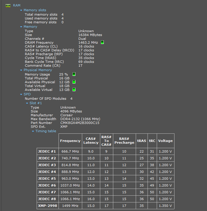

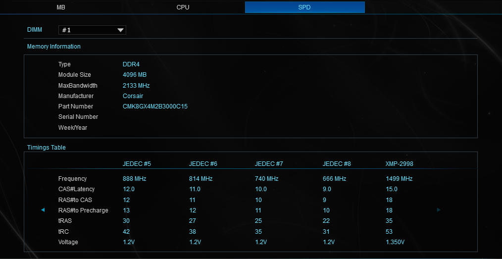

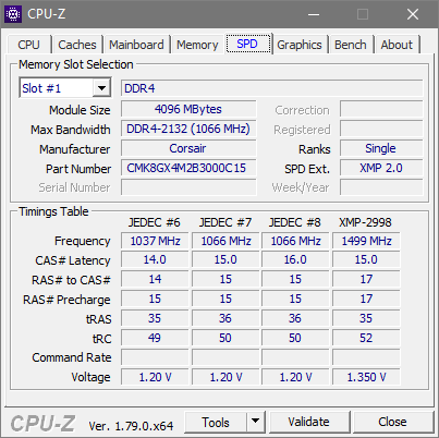

    I have a PC, in it the RAM is DDR4 3000Mhz. Motherboard is an Asus b350m-a. I cant get the ram clock speed past 2133Mhz. This is the RAM I'm using specifically https://www.amazon.com/gp/product/B0123ZBPDA/ref=oh_aui_detailpage_o03_s00?ie=UTF8&psc=1 (16gb total, all channels used)
    Latest BIOS is on it which should have aided me here, OC Tuning doesn't help, I doubt it's a power related issue (450w bronze PSU sucks but wouldnt be the issue), everything else is OCable (even the RX480 in here surprisingly) except this RAM which only fails to boot if I try going higher than 2133.
    Does anyone have any suggestions for me? It's been bugging me for a while.
    On top of this I'm getting varied speed readings as well from some tools on hand.

    Decided to take a look at the verified vendors for memory since that is provided. Searched my specific modules and came across the following entries
    Code:
    CORSAIR CMK8GX4M2B3000C15(Ver3.21) 8GB(2*4GB) SS N/A Heat-Sink Package 15-17-17-35 1.35V 3000 2933
    CORSAIR CMK8GX4M2B3000C15 8GB(2*4GB) SS N/A Heat-Sink Package 15-17-17-35 1.35V 3000 2133
    The last entry, where theyre different (2933, 2133) is on the column for ryzen support. Mine unfortunately is the latter, stuck at 2133 due to the CPU itself. That's a shame.
