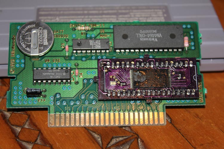

    i realise I'm only a relative newbie on here (more of a lurker than a poster), but I was wondering if I could get some assistance to clear up a dispute I'm having with a seller on eBay who sold me an Earthbound cart that's turned out to be a bootleg copy.
    The following is a photo of the disassembled cart:

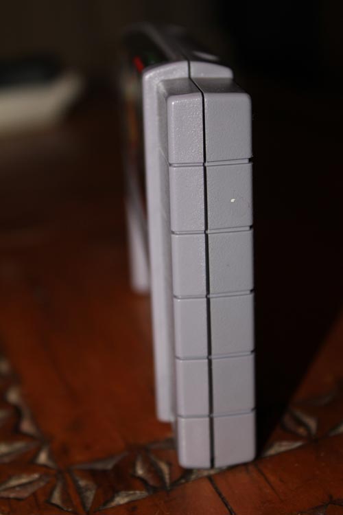

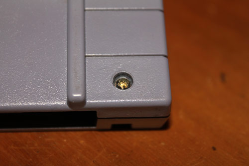

    I also noticed that the cart was not sitting flush on the side that the NAND IC has been soldered to the cart and that one of the screws had also been stripped bare.

    Correct me if I'm wrong, but it looks like the seller took a legit board and added an Earthbound eprom.

    Close but not quite. That is a TSOP->DIP adapter board purpose built for such occasions. Instead of an EPROM it has a piece of TSOP flash soldered to the small PCB; very different technologies but the same end result. An example:
    http://www.buyicnow.com/vp.php?pd=2503

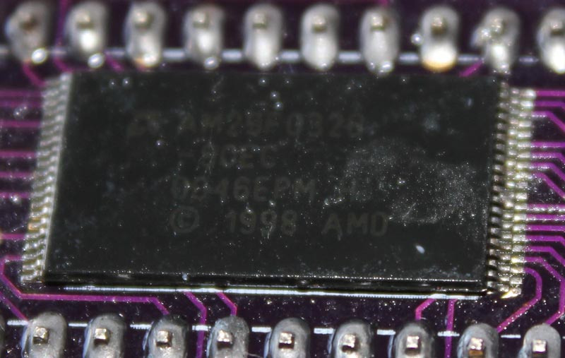

    Another possible way to verify it is a bootleg is to take a high rez shot of the TSOP flash chip and decode the date code. Unless Nintendo can travel to the future to take back future NAND that datecode will reveal it is far too new to possibly be used in a SuperNES cart.

    As APE said, the cartridge contains a TSOP Flash chip that did not exist in the year that Earthbound was manufactured. Also it is common knowledge that retail SNES games contain a MASKROM chip. They do not contain programmable ROM chips.

    I've gone through the photos I already took and jumped in for some hi-res shots of the IC, and look what my delightful camera managed to capture - here's the full frame shot:
    And here's the crop:
    An AMD chip from 1998 in a SNES cart manufactured in 1995? Madness!
    I'll link back to this thread in the documentation I'll send over to PayPal and include the technical details in addition to the new pics.

    Images demonstrating the bulge on the case and the stripped screw:

    Just because the copyright date on the chip is 1998 doesn't mean it was manufactured in 1998. Could easily be much newer than that which aside is still manufactured after most SNES titles ceased to be manufactured.

    That TSOP to DIP PCB came from dorkbot PDX, which has only been doing PCB orders for about two years now. Purple with tabs is a dead giveaway.

    NOR, not NAND.
