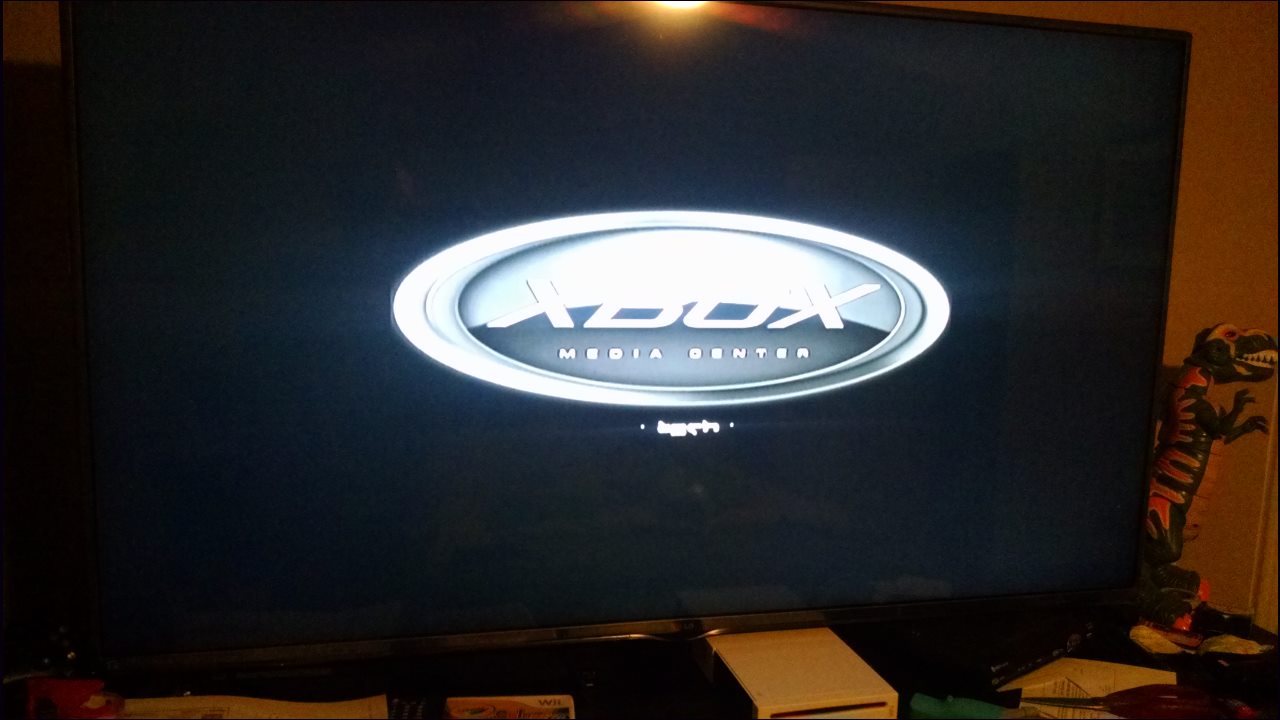

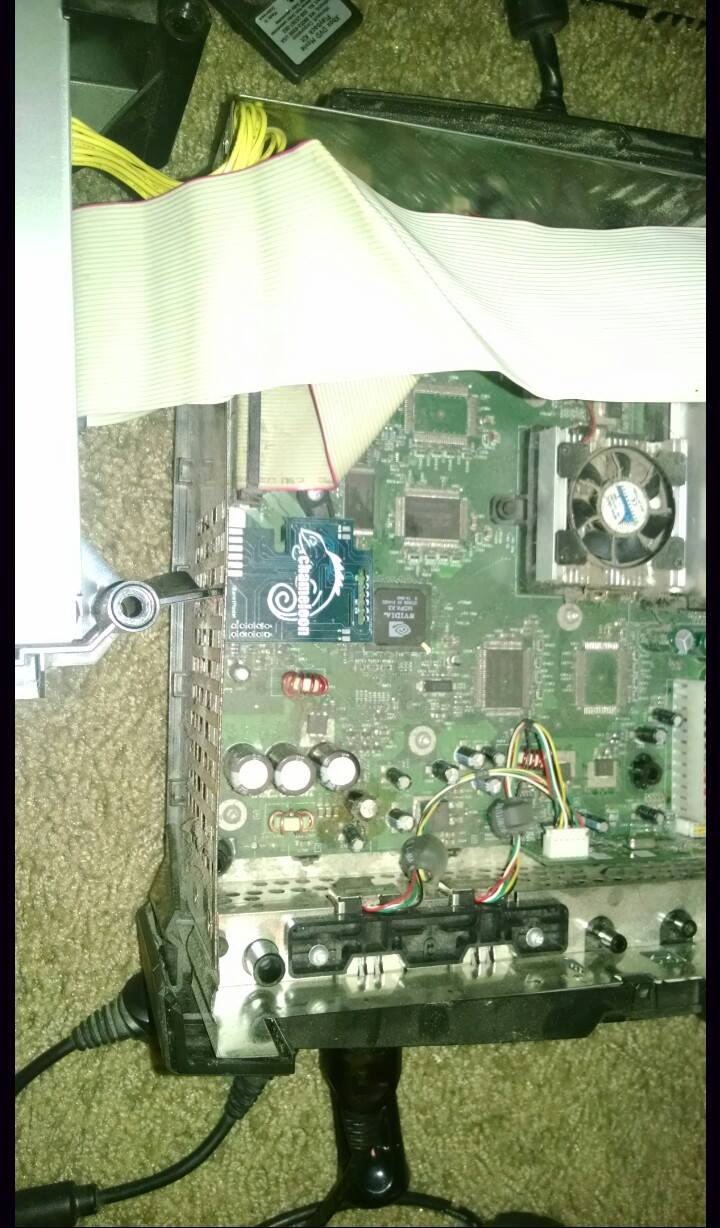

    So I bought this a couple of days ago and have been navigating it to try and figure out what exactly I have on my hands and what its capable of doing. From what i have been able to compile here are my findings:
    (pics attached below)
    Mod Chip: Chameleon ?

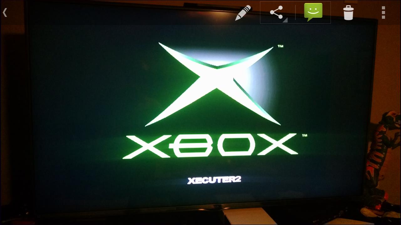

    Bios: Xecuter2 4978.03

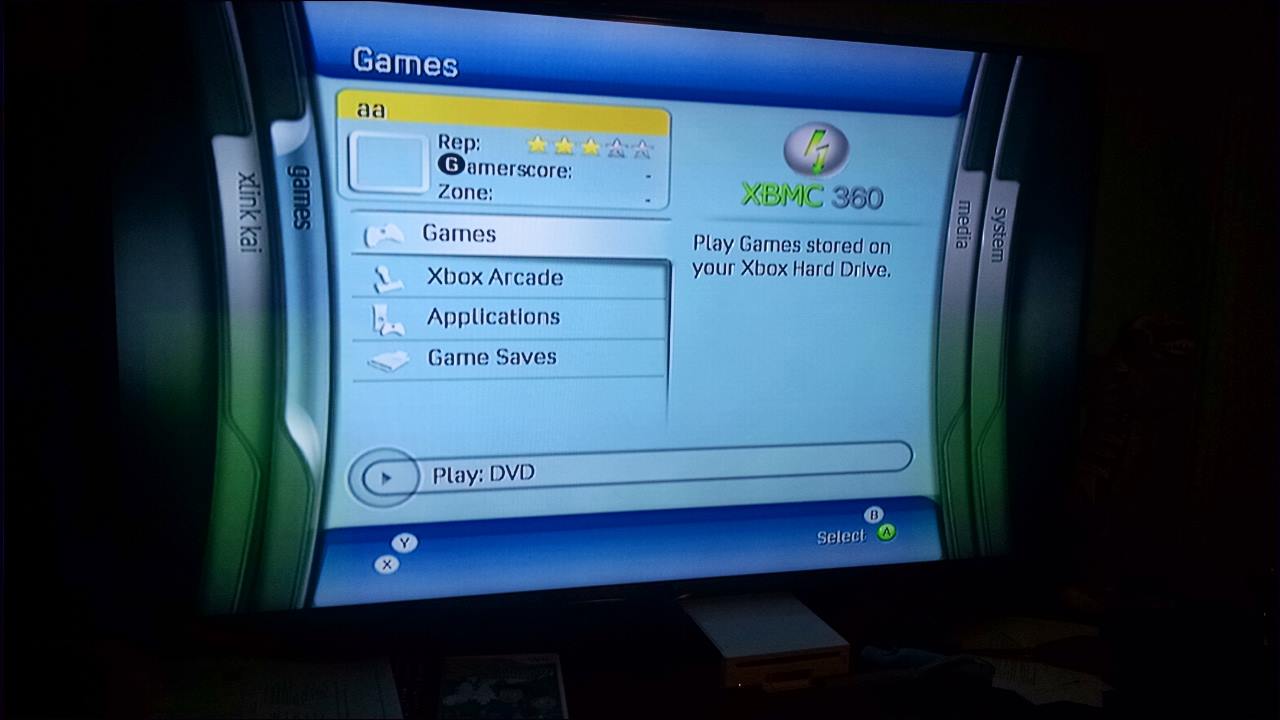

    Dash: XBMC 360
    Plays backups on DVD disc
    Has a SNES emulator but no roms
    Tiger Woods PGA Tour 07 loaded on hard drive. Game will not load when I click on it just goes to blank black screen.
    I've been trying to google my way thru all of this to get more info but I guess now my lack of software/programming knowledge has me at a standstill. I would like to get help on figuring out how to get the emulators and roms on the hdd. I tried a video tutorial that told me to use Filezilla and connect my xbox to my router and basically just drag and drop from my PC to the xbox BUT in the video the guy has different partitions within the HDD but mine only finds :/C and appearantly the emulators and other goodies go on the :/E . Heres a link to the video tutorial i tried to follow.
    Thanks in advance for any and all help provided.

    Dang awesome find! Would LOVE to find that chip.

    Its just a chip I don't have in my collection. They all basically do the same thing.

    Also, what a waste of a rare chip, it's a v1.0 and could be TSOP'd :p
