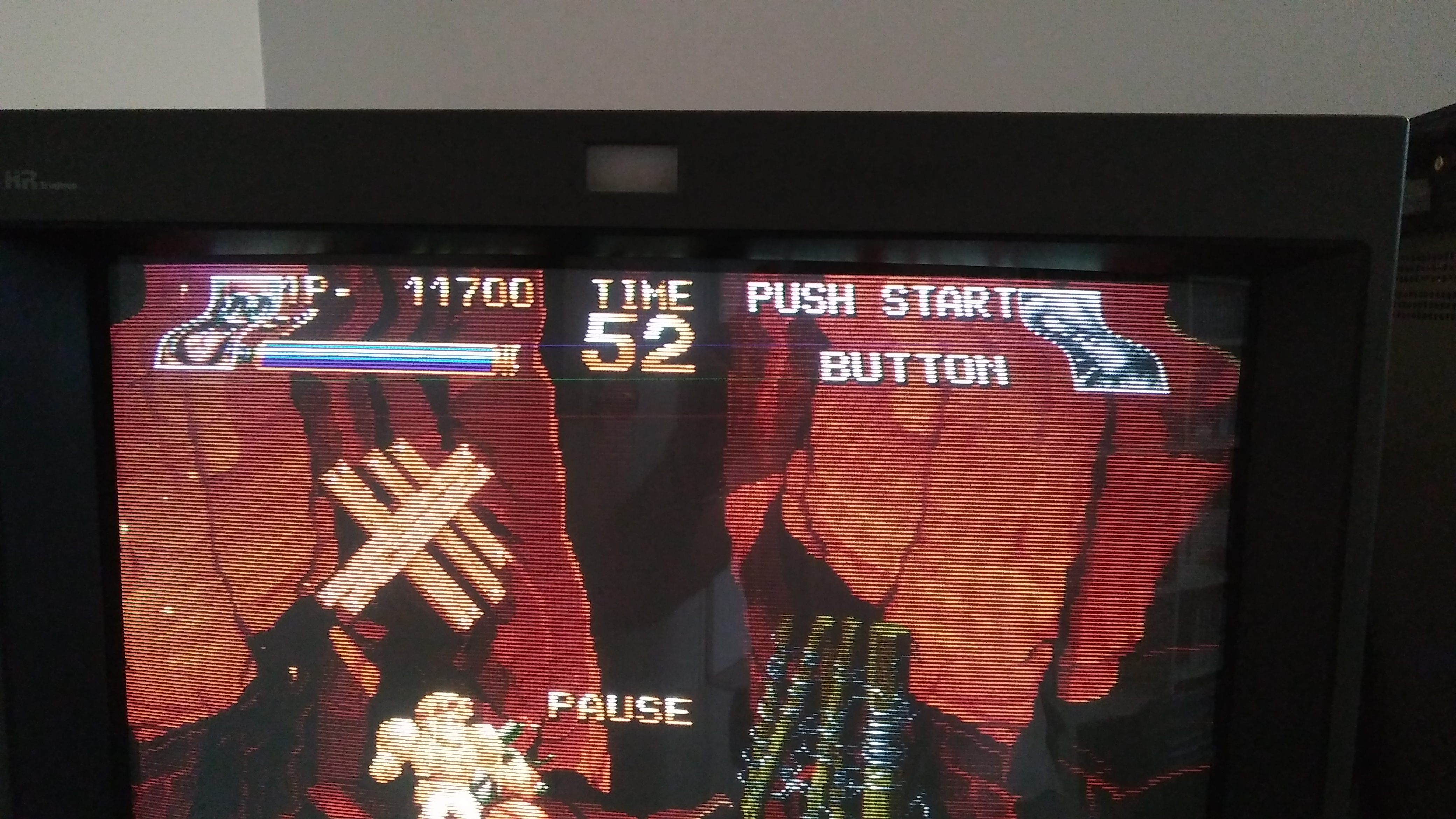

    Hi all,
    I am from Australia and recently acquired a Sony PVM - 20M4A off ebay.

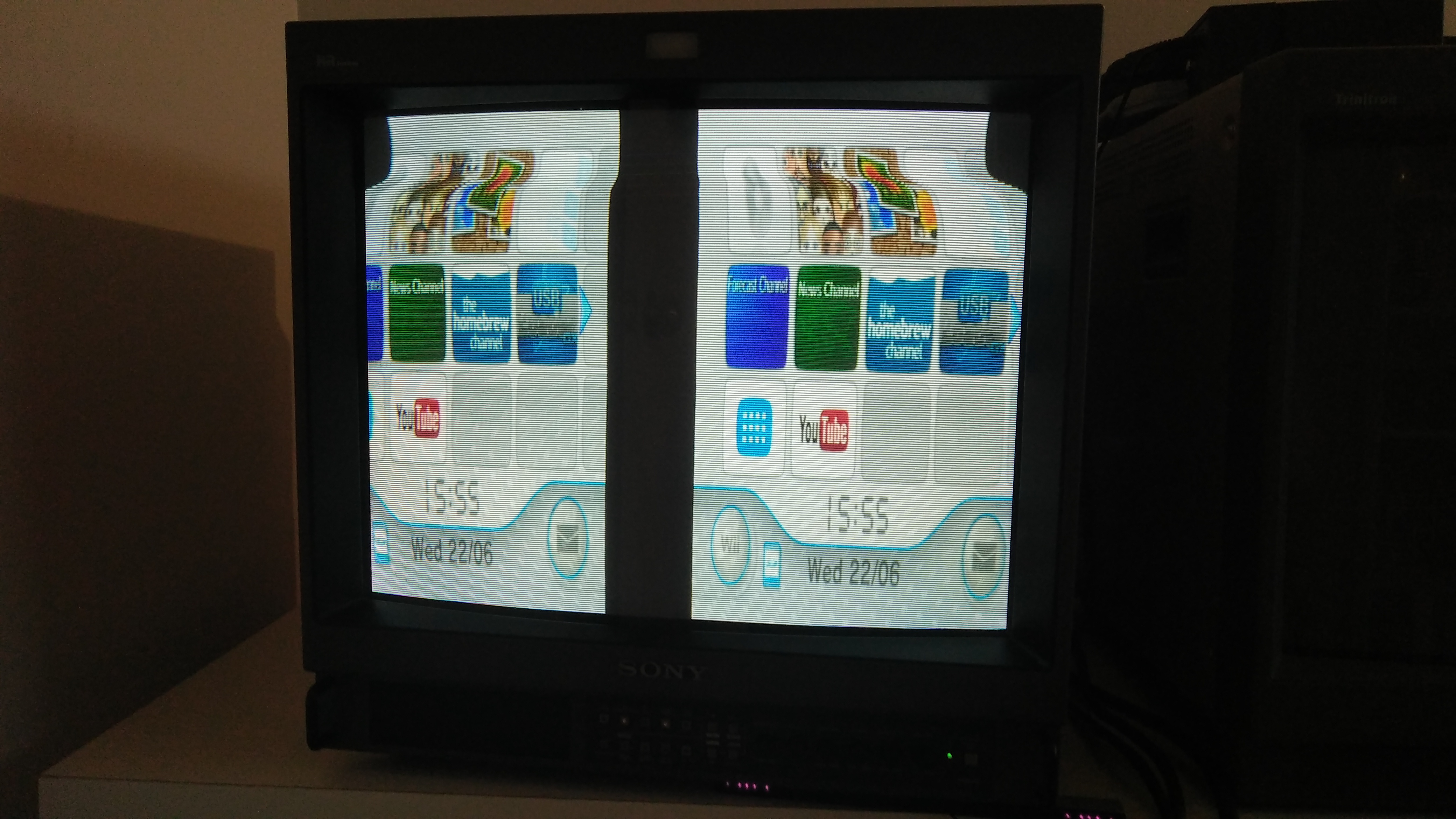

    But when I test it I get empty spots in the top left/right corners... As per attachment.. How can I fix this? Will the service menu fix this?
    Secondly, I have connected my Wii using the Component connection on the PVM and it accepts 480p but the screen is split in half....What am i doing wrong?

  2. Xzx123
    Xzx123 Robust Member
    Mar 19, 2013
    271
    65
    While I don't think this will necessarily solve the problem, have you tried adjusting the Horizontal Hold to see if it has any positive effect on the top of the screen?
  3. chingy213
    chingy213 Active Member
    Jun 12, 2016
    not sure how to get into the service menu to do that... the main menu does not have that option to adjust
    Edit:
    I got in the service manual and its very difficult to navigate :(
    Edit:
    I fixed it. It was service menu issue, there is 120 options, option 8 had to be adjusted.

  8. ASSEMbler
    Just be careful of service mode, you can actually permanently lock yourself out of the pvm with it by accident.

    65
    What was option 8's name?

  11. Kaeser
    Kaeser Active Member
    Jun 15, 2016
    49
    The PVM 20M4A does not support 480p.
  12. chingy213
    Jun 12, 2016
    I thought so. Thank you for clarifying this mate
