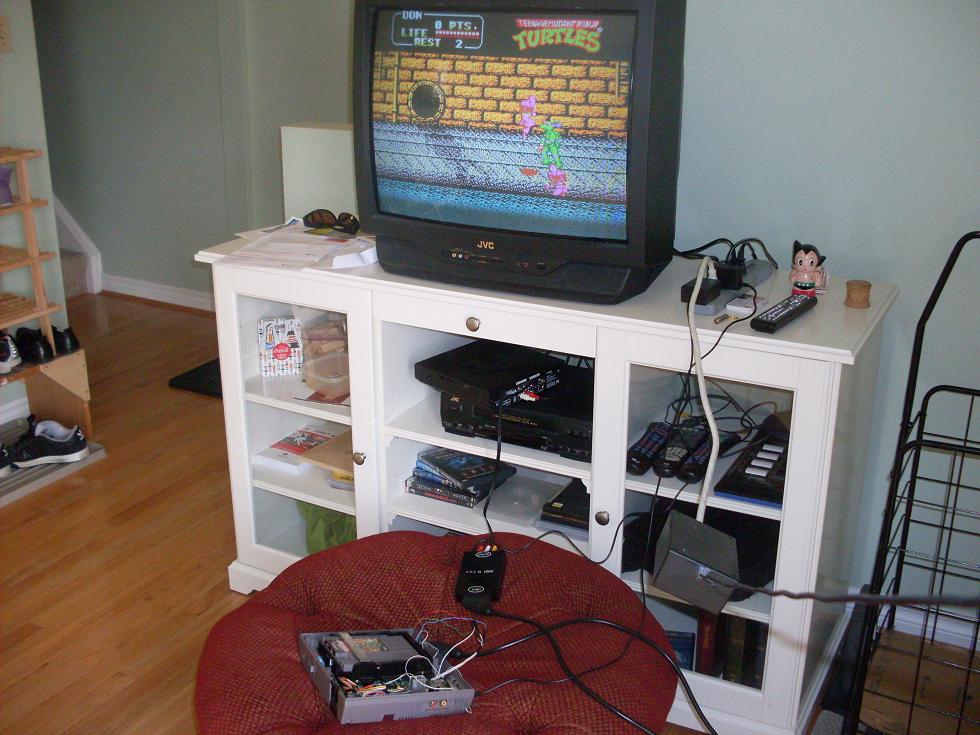

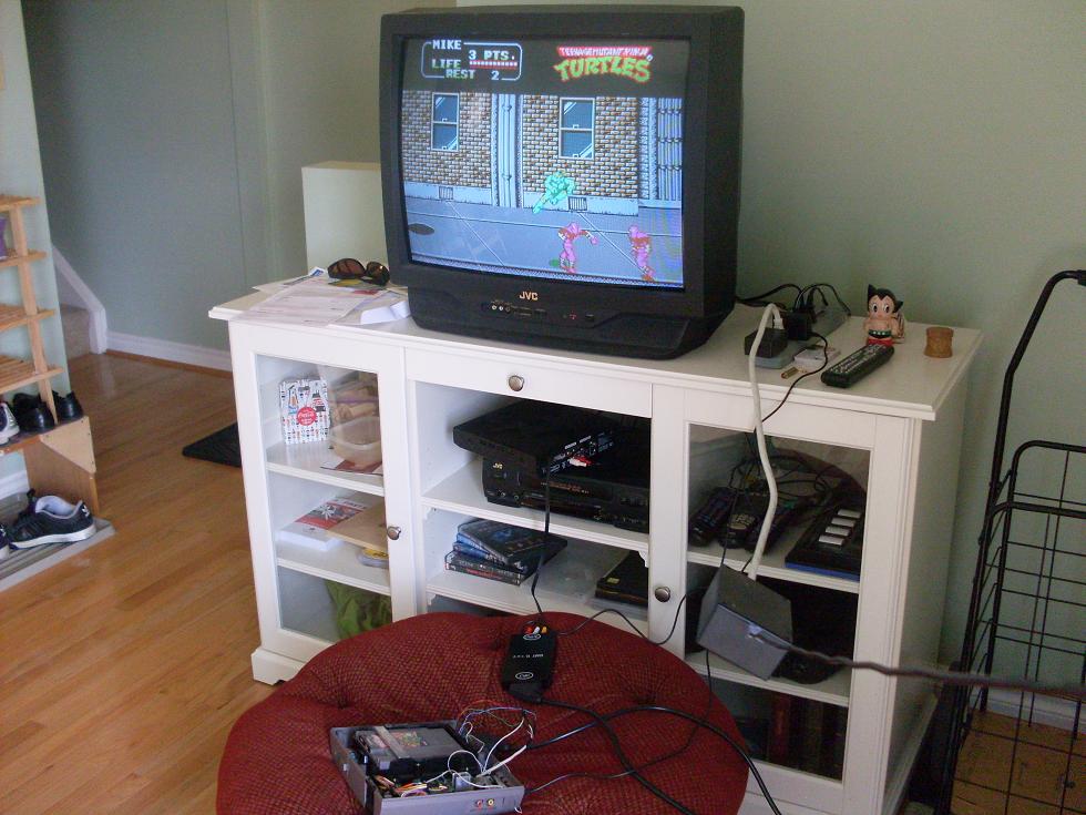

    Sorry about your system. I use sop to dip adapter boards for the ths7314. Worked fine in rgb nes systems:
    I recommended two people try the ths7314 amp to bypass the video encoder in the onechip snes and they both said it works great as well as removing the translucent bar in the middle of the screen. I've never tried using the ths7314 on anything else but I'll be trying it in pc engines soon.
    I don't think the ths7314 is a bad amp.
