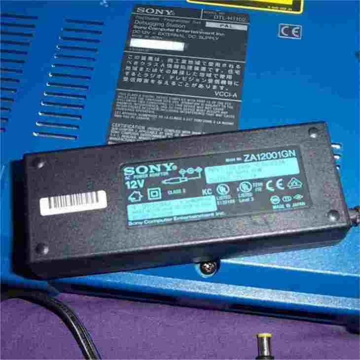

  18. As Kyuusaku mentioned...
    ...Here's a pic of one of mine to show the external PSU.
    PAL Playstation Debugging Station = DTL-H1102
    ...External PSU runs on 100-240VAC
