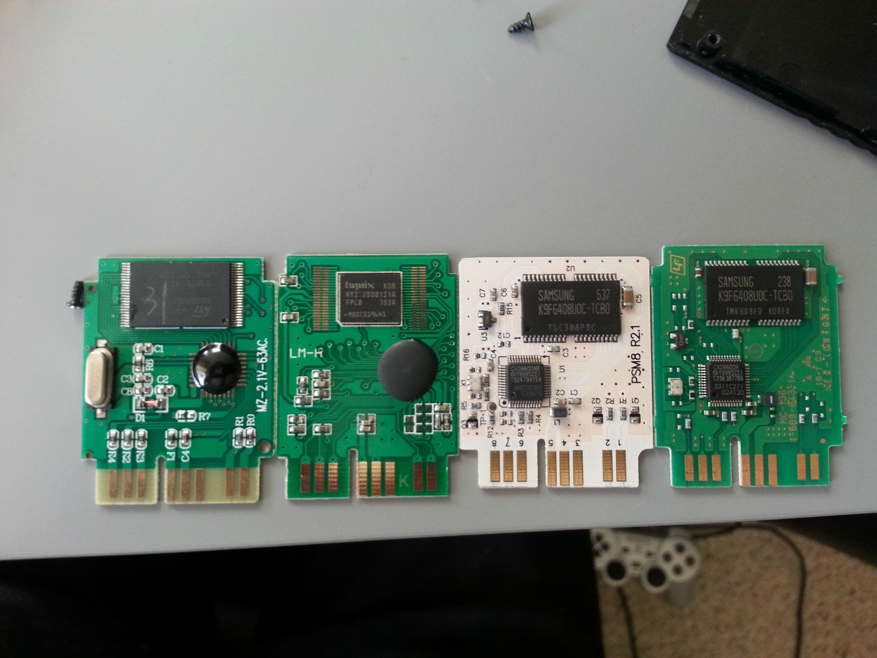

    So, long story short, I bought some memory cards from china on eBay and they were maked as 8mb in capacity. Upon entering the browser, they showed that they were in fact 8mb cards. As I had heard of a myth involving these cards, I loaded up action repay max, formatted them in max memory, and now the browser shows that have quadrupled in size to 32mb! I opened one of them up and they use 256mb ST NAND chips and a controller chip under an epoxy glob. Compared to pictures I've seen of other fake memory cards, mine looks even simpler. I counted all of 6 resistors, 5 capacitors, 1 diode, 1 fuse, and a crystal. Ill get a picture of the board if anyone is interested. It's what I expected, being only $2.95 per card with free shipping haha

    Wanted to report that I've found a knockoff (Ok, counterfeit) that appears to work with re4 (and other newer sdk games I presume). It also works with fmcb and has better seek times then e other card I had before. I opened it up and spotted a 512mbit hynix BGA chip even though it comes up as an 8mb card. However, unlike the previous cards I used, formatting it with Armax doesn't unlock any additional space. Maybe th caught on to this little "trick" haha

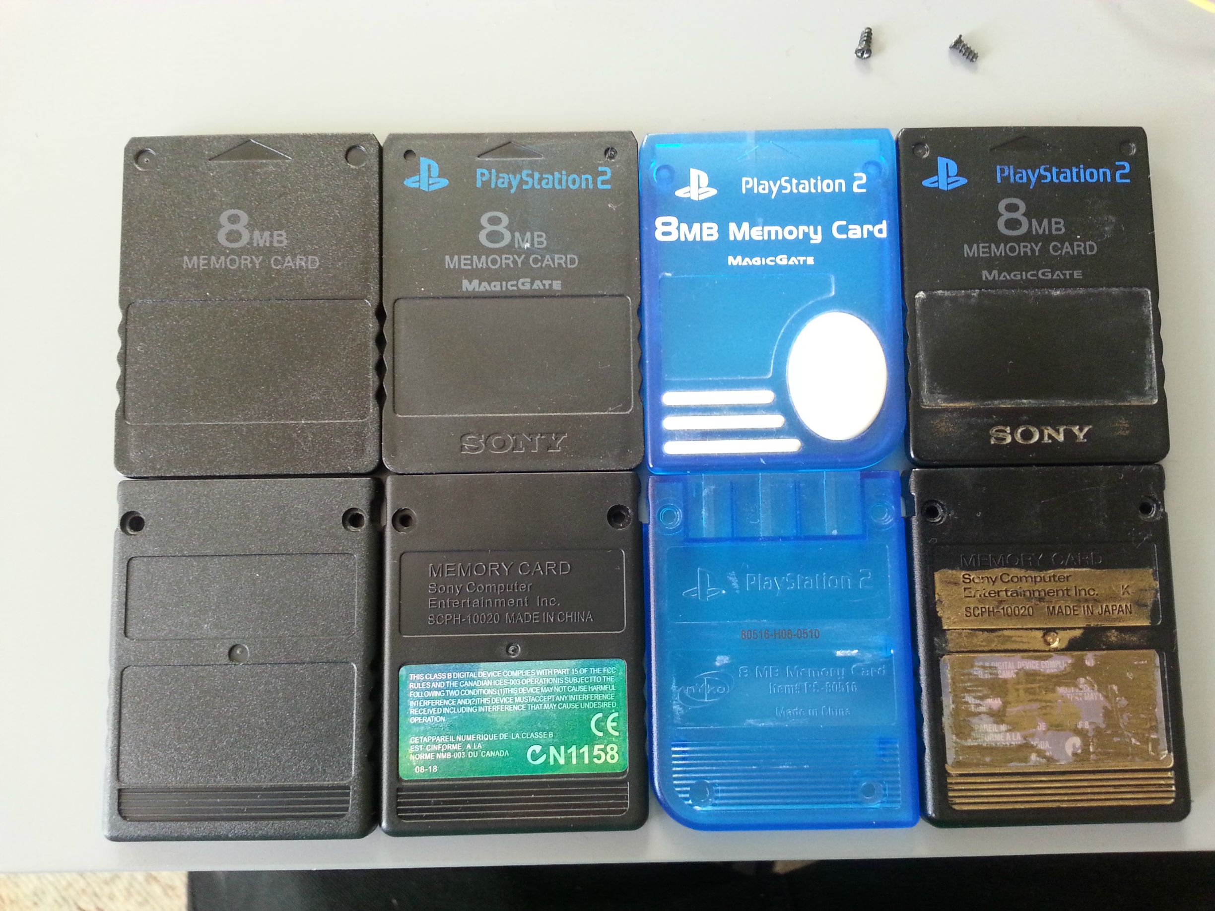

    Here's a comparison of a few memory cards I have with some notes
    From left to right:
    • Card 1: Generic, contains 256MBit NAND chip. Came formatted to 8MB, but when formatting the card using Action Replay Max, you can unlock the full 16MB. This card has issues with recent SDK games (such as Resident Evil 4). Only card in the lot to use a crystal. Read/write times are the slowest on this card compared to the others here.
    • Card 2: Counterfeit, contains 512MBit flash chip (BGA). Locked at 8MB and can't be formatted to 32MB using AR. Has faster read/write times than any other card I own (including an official Sony one!). This could be a side effect of its newer, less used flash chip possibly. Worst build quality of the 4 shown.
    • Card 3: Officially licensed Nyko 8MB card. Contains a Sony CXD9600AR controller chip and uses the same Samsung RAM as an official. As expected, the compatibility is the same as an official Sony card.
    • Card 4: Official Sony 8MB card, purchased in 2002. Contains a Sony CXD9600R controller chip. I guess I felt the need to cover the outside with gold Sharpie some years a go :moody:. This card is constructed better than the other ones pictured, by the Nyko comes pretty close.
