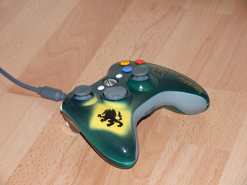

    That's an interesting solution! Can you please share a pic?

    Here you go.
    Unfortunately I don't have a better pic and this happend to be the first time I was using the decal paper. I think the Griffin came out slightly better because it was printed on transparent paper and therefore was easier to cut out and blended very well with the clear spray paint. The paint job wasn't one of my best and I was planning on re-doing it but ended up lending the pad to someone and never getting it back, so never mind.
    I'm redoing the logos on a SNES soon, so will post up the results when it's done.
