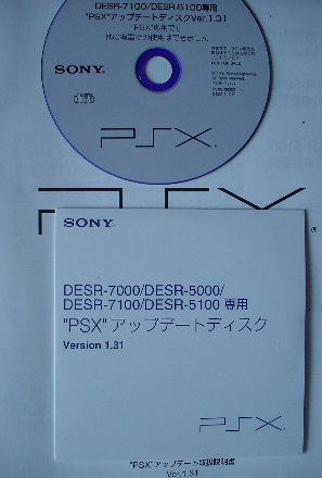

    Leonard, would you class the DESR update discs as PS2 system utility discs?

    If they have the characteristic PBPX-xxxxx naming, yes...
    I never had much chance of tinkering with the PSX or even the update discs. When I asked for a harddrive image for analysis the reaction was cold shoulders ... So I can't really help it but keep sucking my thumb wondering ... :lol:
    If you can check the disc contents and IDs it would be good for adding them into a sort of database. :thumbsup:

  13. unclejun
    Nov 12, 2005
    1,912
    120
    There are four update discs, PSXC-00201 to PSXC-00204.
    Update 1.10 for DESR-7000/5000:
    \SYSTEM.CNF
    \PSXC_002.01
    \S_DUMMY
    \FILES\FILES.PAK
    \FILES\INSTALL3.PAK
    Update 1.20 for DESR-7000/5000:
    \SYSTEM.CNF
    \PSXC_002.02
    \S_DUMMY
    \FILES\FILES.PAK
    \FILES\INSTALL3.PAK
    Update 1.31 for DESR-7000/5000/7100/5100:
    \SYSTEM.CNF
    \PSXC_002.03
    \S_DUMMY
    \FILES\FILES.PAK
    \FILES\INSTALL3.PAK
    \FILES\REPLACE.IMG
    Update 2.11 for DESR-7500/5500/7700/5700:
    \SYSTEM.CNF
    \PSXC_002.04
    \S_DUMMY
    \FILES\FILES.PAK
    \FILES\INSTALL3.PAK
    \FILES\REPLACE.IMG
