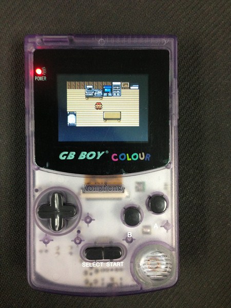

    I have a arcadie for Iphone and was planning to build a mini arcade machine with one GB Boy color (clonic Gameboy color backlit), since the size of the screen fits nicely into the arcadie´s marquee and it would only need to add the Start and Select buttons.
    My only question is whether you can take the controls of arcadie to connect them at the contacts of the buttons on the motherboard of the GB BOY.
    The idea is quite attractive because the cost of having a mini arcade machine would be paltry compared to some I've seen here in excess of €100 (if not also have to make the furniture, which can throw you back or you can not have necessary tools). The price of everything could be around 40 € (the arcadie only costs € 9.95 at)

    There is an image of GBC board (not GB COLOUR one because I dont have the screwdriver to open it). Just for make us an idea:
    So, after all. There is any possibility to connect the Arcadie controls to the GB Colour motherboard functionally?

  3. Flash
    Flash Dauntless Member
    Oct 18, 2011
    739
    67
    wires and soldering iron, that's all.
  4. cdoty
    cdoty Gutsy Member
    Mar 23, 2005
    413
    I don't think it will work as a switch. My guess is pressing the buttons changes the capacitance of the tip.
