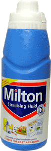

    I wouldn't recommend this method at all. I would say that standard anti-bacterial kitchen cleaner would do a better job of sanitizing than a dishwasher! I've seen diswashers do very poor jobs of plates and glasses, not to mention the damage done to certain patterns etc. (and don't forget, your controller has printing on it). Then there are the controllers that have labels - they're going to get trashed! Plus... do you really want all that crap in your dishwasher, with items that come into contact with your food?!?
    Far better to invest in a can of foaming cleaner. It does all the hard work for you, you just wipe it off. This is what we used in the games shop I worked in, and the owner had done so since the days of 8 bit micros.
    Or you can use a household cleaner - for really dirty consoles and controllers, I use Milton fluid (sterilizer for babies).
    *EDIT*
    Incidentally, you don't want to wash the rubber contacts. They have a carbon conductive surface - destroy (clean) that and the buttons won't work!
