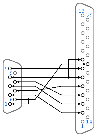

    Hi. Well since there is no Amiga (Commodore) thread, I am just wondering if someone can explain to me, how to copy from the PC to the Amiga, disc files?
    I have seen it done, where they put a blank Amiga formatted disc into the Amiga, and they copy the file over - but I am confused to know what a null-modem cable plugs into on the PC.
    I read you do not put it into your standard parallel (DB-25) printer port (LPT1), but into a modem port. You can also use a DB-9 port which is also a special modem port...
    What is this port?
    Or can someone help me?
    I really want to copy some games over / music :crying:

  6. josiahgould
    josiahgould Spirited Member
    Sep 1, 2009
    167
    Make sure you get it wired up correctly. You'll also need a program on the Amiga to receive the file. I bought Amiga Forever and it works beautifully with my A500. It includes the Amiga Explorer, but Amiga Explorer is also available from them separately for $10. Also lets you dump your BIOS and transfer to and from a hard disk (if you have one).
    Oh yeah, if you're making the cable yourself, be careful. Pins 9 and 10 have voltage on the Amiga side and if you tie them together you'll fry your little friend. I bought mine from an Amiga website, but here's a page on it.
    http://www.etheus.net/Amiga_Data_Cable

    I wired it like this
    I am going to use Windows ME with AmigaTRANS.

    OK that software is shit...
    I dont really want to buy Amiga Explorer. The shareware version did not even work on Windows ME, even though it said it did. I even tried it on Windows 7. When I open it (on Windows 7), it takes 40 seconds, then just says "Error reading from COM port.".
    Windows XP, Vista and 7, are not good at the original COM stuff...
    Also, that guide you linked is for Linux and to only RECEIVE data. Incorrect cable...
    I want to SEND from my PC to the Amiga.
    Why is it so damn hard to make an Amiga disc! lol

    Well I guess I don't have a choice. I will have to buy the software. It is only $10 separate so that's ok.
    I may have to also just buy the cable too. I made one (image above), but of course there is always that chance that can be the issue like the issue I had with the Xplorer for the PlayStation :p

    OK I received the cable, and it works perfectly.
    I got all the stuff I need copied.
    I had to however, use a MS-DOS program to convert .DMS to .ADF.
