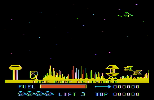

    Took video off pin 36 of the ColecoVision graphics chip; got composite, but there is a rainbow effect on the image - I believe this is usual from this old chip.
    What, if anything can I do to get the image normal and stable, no rainbow effect?
    This is what I mean:
    Example from someone else's post:
    ColecoVision composite:
    What it should look like:
