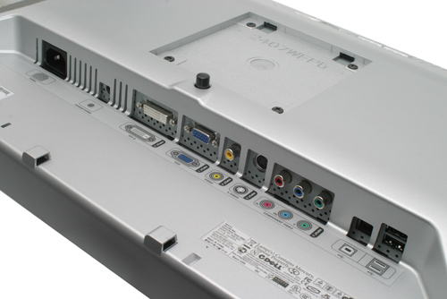

    My current monitor is a Dell UltraSharp 2407WFP-HC which has loads of connectors at the back of it (Composite, Component, S Video, VGA, DVI) and is a great montior- even for 2007.
    However, I have tried to attach an Xbox (1) to it before but got no sound out of it. Derp, no speakers in it! However, there is no connector for speakers, so I have no idea how to get sound out of it. The USBs on the side of it don't (seemingly) work, as I plugged my Bluetooth adapter into one and the 'on' light didn't appear. Specifications PDF is here: http://www.dell.com/downloads/emea/services/en/UltraSharp 2407WFP-HC_EN.pdf

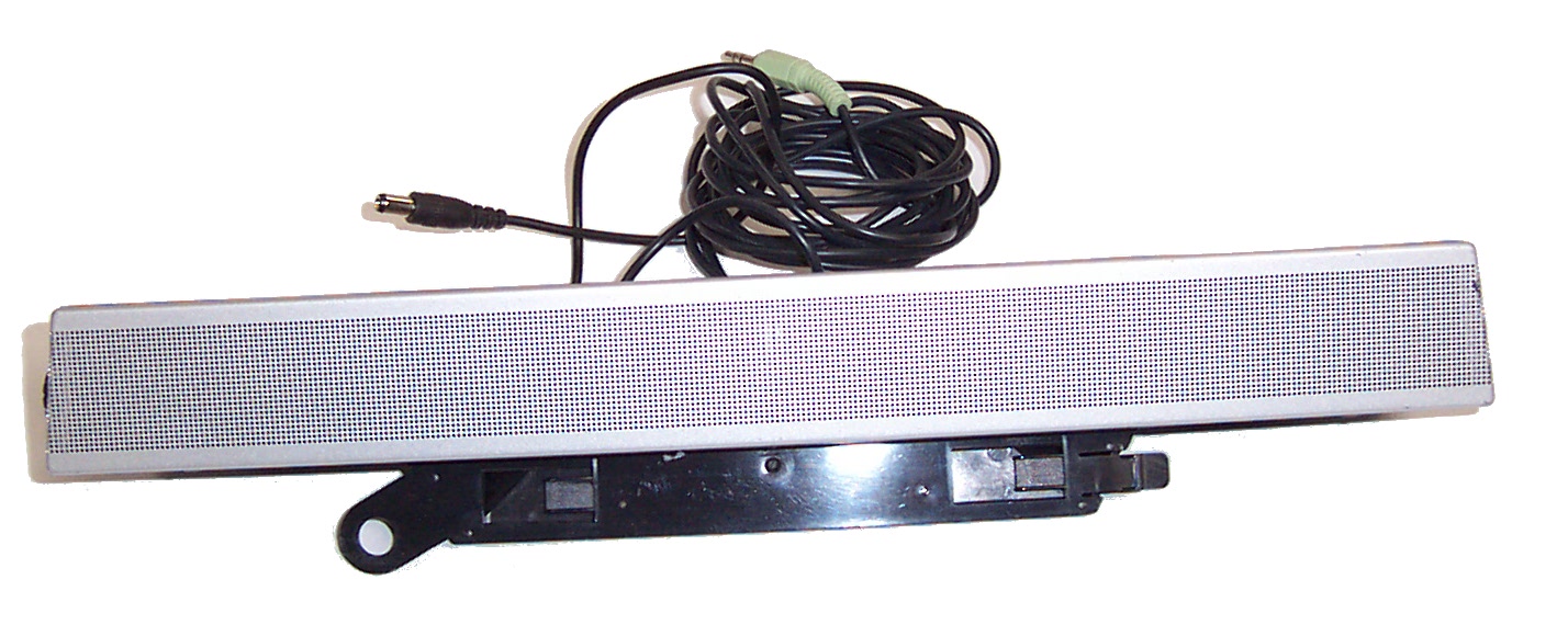

    "• Easy attachment of optional Dell 10W multimedia soundbar AS501."
    I checked it out, and it seems just like an attachable speaker which plugs into your computer.
    So what the heck is the point in all those connectors if you can't get sound? This is confusing me beyond belief- does that mean the connectors are just useless? Help :dejection:

    Attach the speaker to the monitor, plug the (short) power cable into the port on the back of the monitor and plug the stereo (green) cable from the speaker to a stereo mini jack. The monitor itself only provides power to the speakers.

    Your monitor will act as a USB hub. The single "Type B" USB connector goes from your monitor to a USB port on your PC. Once connected, the two "Type A" connectors will be powered as well as function.

    Your monitor doesn't have any sound inputs or outputs, so you'll have to connect the speakers directly to the console. Plug the red and white RCA plugs into an adapter like this: http://www.ebay.co.uk/itm/171004551128 and connect your speakers to the other end. Only the yellow RCA (or s-video) plug goes into your monitor.

    Basically, your monitor does not and cannot output sound, you must use speakers completely independently of the monitor, all of the connectors on the back of your monitor are video ONLY
    The only exception being that dell sound bar you posted a picture of earlier, and even that only takes power from the monitor and still must take the sound directly from the console using the adapter linked to above. I'm not really sure how this can be made any clearer for you?
