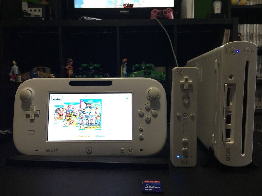

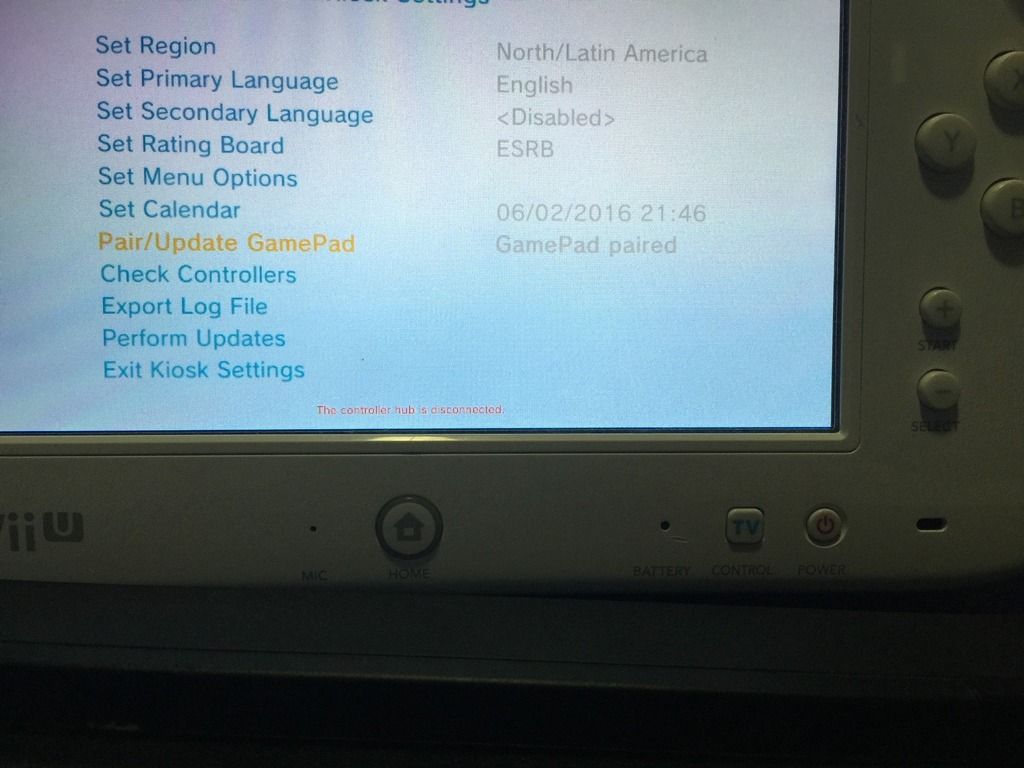

    Here's a short tutorial for everyone on how to pair the Wii U kiosk gamepad to a Wii U kiosk console either a Wis-001 or Wis-003
    Items needed to perform this.
    1. Wis-001 or 003 console
    2. Wis-001 or 003 gamepad
    3. Standard Wiimote
    4. Sensor bar
    5. Sd card can have anything on it

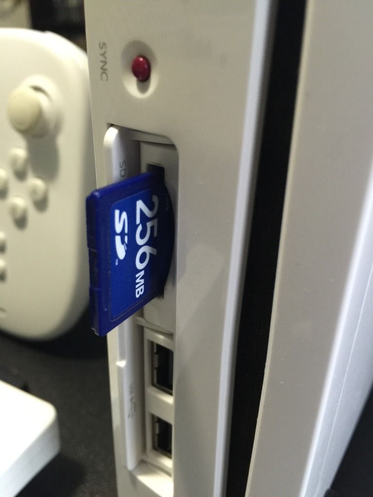

    Once you've connected your console to the gamepad power wires and sensor bar place the sd card in the slot before the unit powers up. There is a 30 second delay before it will start once you plug the power cord in.

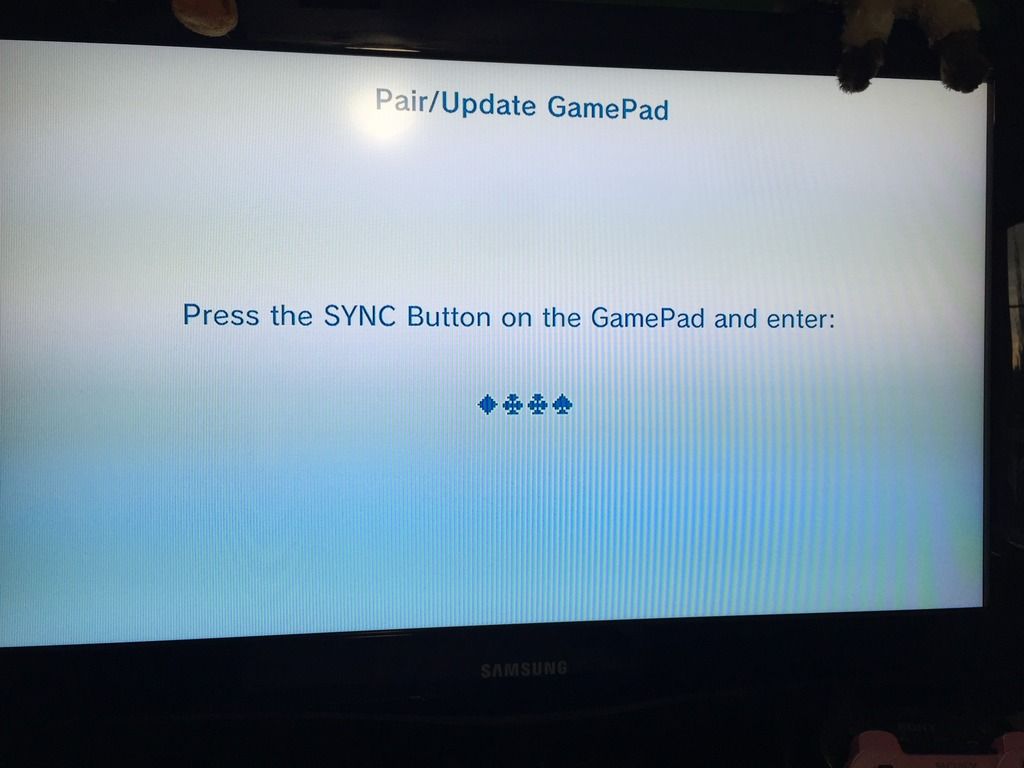

    Once the sd card is inserted the system will open up a settings menu. At this point you will need to pair the Wiimote to the console by using the sync buttons on the console and wiimote
    Now that the Wiimote is paired with the console use the directional pad to scroll to pair and update gamepad and click on it.

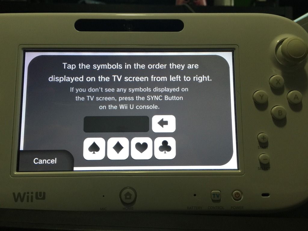

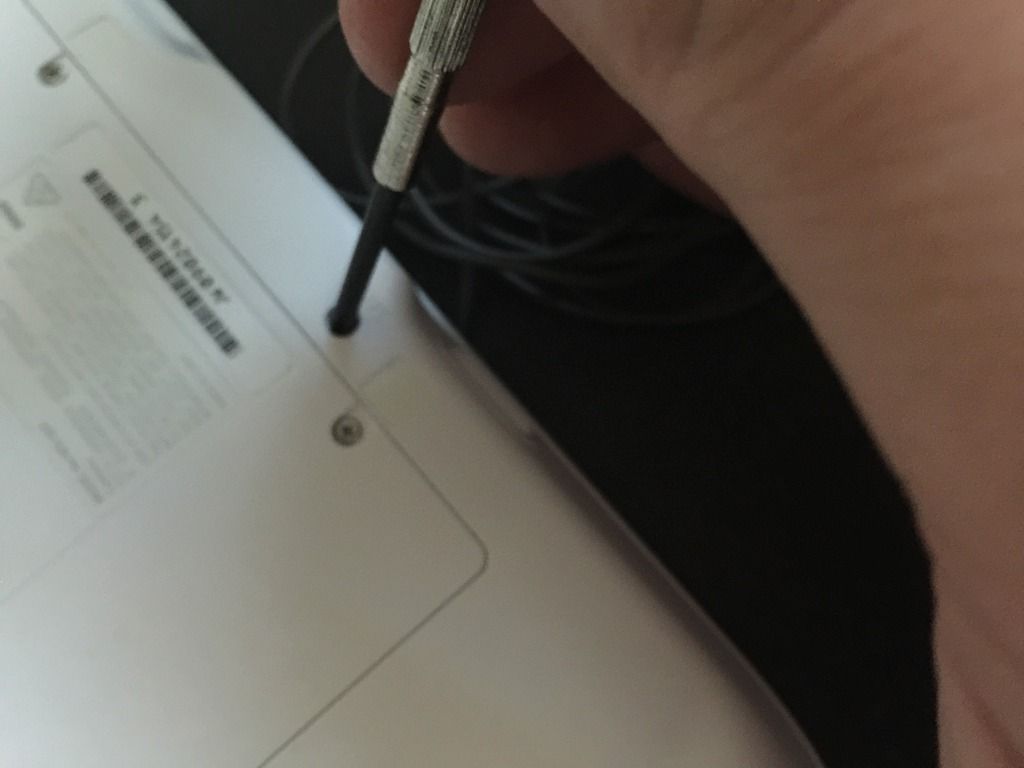

    After you have clicked on the pair and update menu it will take you to the pair screen. Once here you will need to push the sync button on the back of the gamepad until it resets and displays the pair screen on the gamepad. Now enter the symbols that are displayed on the tv into the gamepad and you are now synced and ready to go.

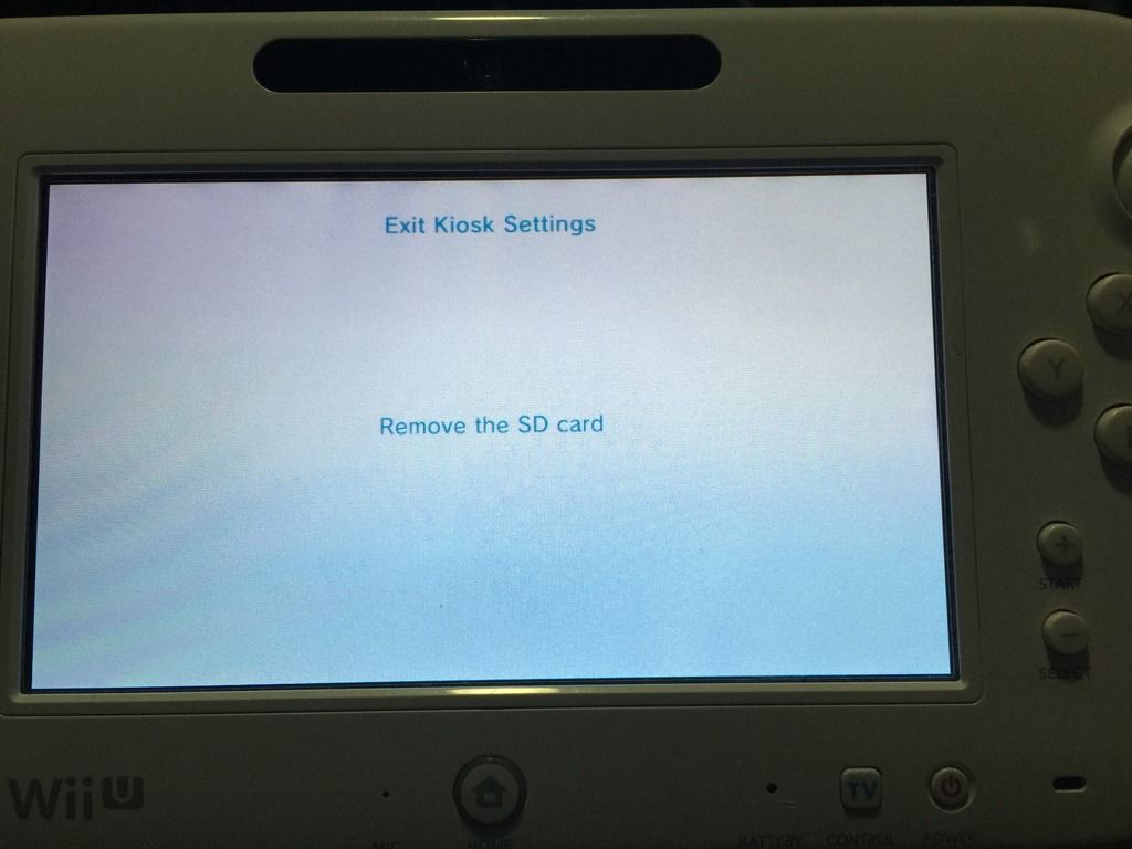

    Once finished a pairing complete prompt will display on the gamepad push any button and now your ready to use the gamepad. Scroll to the bottom of the menu and exit. You will be prompted to remove the sd card and the console will now display the kisok screen.
