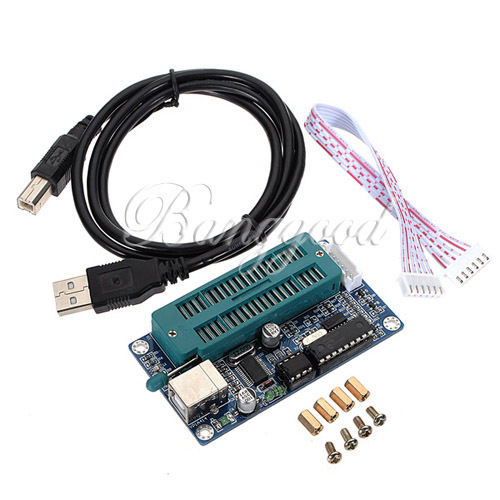

    SO far I have purchased this cheap unit.

    It is as simple as you think. I use a serial jdm pic programmer, pretty cheap.

  4. ChemicalBro
    ChemicalBro Spirited Member
    Apr 6, 2014
    104
    Most of them all will work fine for this. WinPic, PICProg, are a few others.
    Just remember to keep track of the osccal for 12f629. See http://picprojects.org.uk/projects/piccal.htm
    Someone else might know the technicalities why.
    According to master991:
    For scph 100X series the best chip it's mayumi V1 or V2 or Multimode V2.
    MM3 or mayumi V4 are absolutely not reccomended for 100X series.
    Just google 12f629 mm3 and it'll come up with relevant links for your region.
