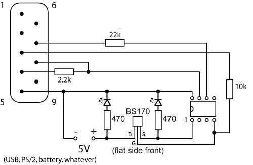

    Simple enough.
    The 2 LEDs are not necessary but useful so all you need is a PC Serial port, couple of resistors and a transistor. Use it to program 12f 8-pins PIC devices with WxPic software or anything similar (WinPic800...). You'll be able to program 12f508 and 12f629 chips with it.

    I doubt OP will manage the lowtech solution without handholding, that is, if it even applies - since we still don't know what kind of mod he is talking about exactly, and this doesn't help at all with things like e.g. a commercial XBOX 360 RGH "chip".

    If you use WinPic(800)/WxPic/... and built the programmer I referenced earlier, you need to select the appropriate COM port (under Windows) or tty device (in *nix) and select JDM programmer in the programmer list.
    Next select your microcontroller device in the list of supported device by the software. Load up the HEX, blank the chip and program it.
    Surely there are tutorial on how to use these softwares on the internet. These softwares are fairly sample to use, you have multiple tabs containing settings and info, make sure you check all tabs to set things right.
